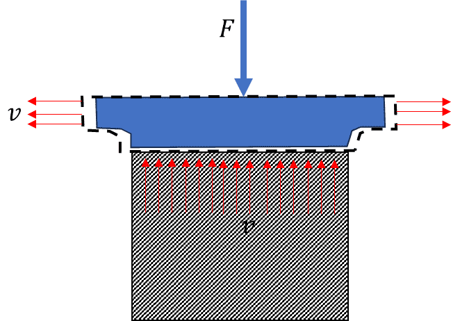

Hello,
I have a circular pipe where there is an inbuild pressure and I have kept a circular weight on it. I would like to know what would be the lift of the weight under certain pressure.
I know the relation that the minimum weight required to keep the pipe closed is F = P*A. (this F will be the required weight to keep the pipe closed.) As there will be increase in pressure, the weight will lift. How do i calculate what would be the lift in case of increase in pressure.
(Assuming that the weight is constrained to vertical direction only)
Thanks
Pressure remains the same after the weight reaches a new height, you just increase the volume of the fluid inside the cylinder.
yes, assuming that as well that the pressure remains the same. How will I evaluate the height at which weight will reach?

Baluncore said:
Does the disc rise and fall within the tube, or does the disc rest on the end of the tube and lift slightly?
A disc resting on the end of the tube will be unstable. The mathematics and the numerical model must also demonstrate that instability.
You must fix the disc to remain horizontal and centred over the tube before you will start getting stable results.
You can get an initial estimate of the gap, based on the following. The pressure outside the tube will be atmospheric. The pressure inside the tube will be higher by the weight/area of the disc. The pressure drop across the lip of the tube can be assumed constant. Bernoulli will give you the velocity of airflow through the gap, based on that pressure difference. The height of the disc, above the tube lip, will be determined by the flow rate of the available air.
yes, it will have constrained to move only in vertical direction. It will not be able to move in horizontal direction.
Okay, using Bernoulli, I will get the velocity, still how do I find the gap using mass flow rate?
Mass flow rate and density give a volume flow rate. Find the area needed for the flow. The width of the channel, is the circumference of the tube in contact with the disc. The height of the gap is area / width.

If you apply Bernoulli's to a fluid jet for an incompressible flow (uniformly distributed velocity - neglecting small elevation head for a gas jet) we find that ##v_{\text{inlet}} = v_{\text{outlet}} = v##, that just implies that ##A_{\text{inlet}} = A_{\text{outlet}}##. I don't think this is useful, as the height is going to be fixed independent of ##Q## by that method? What am I missing.

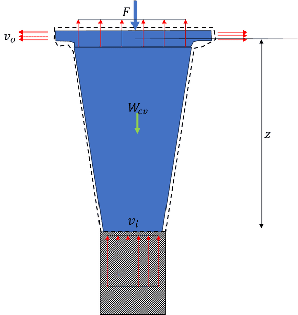

I expect there to be a definite dependence of puck height, on flow rate ##Q##. I would expect the puck to accelerate, reach some point, and oscillate a bit. I think the drag force acting on the puck is decreasing as the flow expands into space. That could account for the behavior if the expansion of the flow field could be modeled.
erobz said:
What am I missing.
I don't know. I am not an expert in air-pucks or hovercraft. I model the end of the tube as a knife-edge below the flow, opposed by the flat disc above the flow. The pressure is dropped across the knife-edge. The pressure is reduced by the weight/area of the disc, with that reduction in PE, becoming an increase in KE, as the fluid moves into and through the gap.

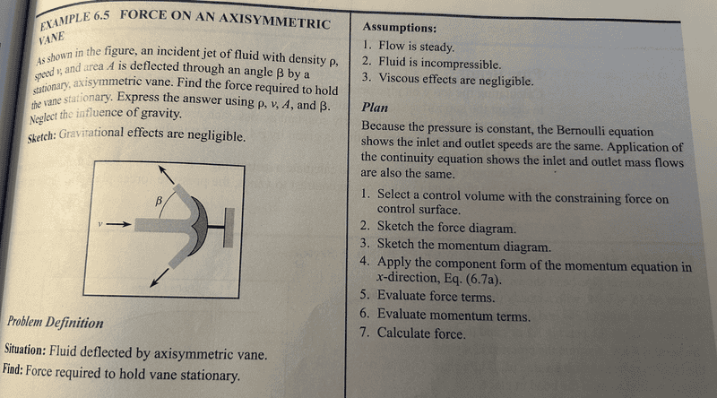

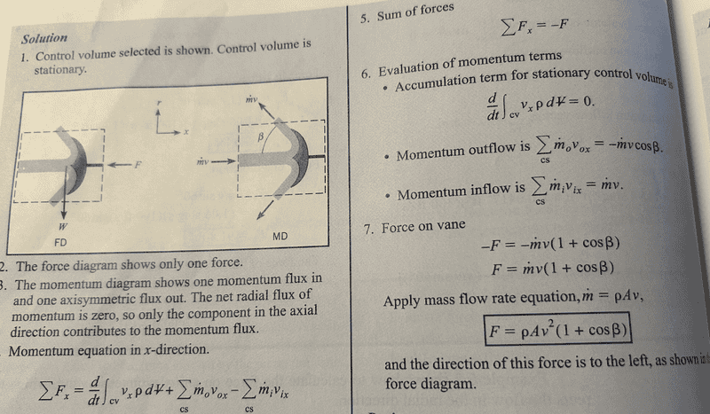

I do expect criticism of my crude initial model. I also expect that criticism to be accompanied by an improved numerical model, that is more realistic.
If you try to invoke Bernoulli's and continuity I get ##A_{inlet} = A_{orifice}##.
## \implies h=D/4##.
The is an obvious flaw with that if you experiment. I stuck small foam ball (about the size of a ping pong ball) and levitated it using low setting and high setting on my wife's hair dryer. Low setting, ##h## very close to the inlet, slightly oscillating. On high setting it climbs to ##H## for my equipment it was on the order of ##h \approx 1 \text{cm}## to ## H \approx 10 \text{cm}##. I don't have an anemometer, nor did I measure and other parameters.
I'm not trying to pick an argument, but it's just not correct, or I'm doing a poor job of interpreting the model. The fluid mechanics is fundamentally more complex and not easily able to be distilled theoretically. I have some examples of some textbook case that I consider in the vicinity of the question, but significantly less difficult of the task at hand.

The solutions derives from application of the momentum equation to the control volume cv(this I don't have a book worked solution for).
$$ \sum \mathbf{F} = \frac{d}{dt} \int_{cv} \rho \mathbf{v} ~ dV\llap{-} + \int_{cs} \rho \mathbf{v} \left( \mathbf{V} \cdot d \mathbf{A} \right) $$
My final result for reference is:
$$ F_T= \rho v_i^2 A_i \left( 1 - \frac{A_i}{A_o} \right)$$
Here is another somewhat related question I feel. The problem is its enclosed in pipe. I feel like the approach your problem is an amalgamation of each problem. I can upload the result to this if interested.
I think we have to be very precise with assumptions. Notice in either of these that Bernoulli's would not hold. The effects to be explored in these problems are implicitly attributed to loss, I have extreme doubt that any application of Bernoulli's make them appear. If you try to apply Bernoulli's to 6.77 you get a direct contradiction to the problem statement.
So potential energy gained by the mass is lost by the flow...ok maybe, but how. What are the assumptions? I see Bernoulli's being called into action in post 11.

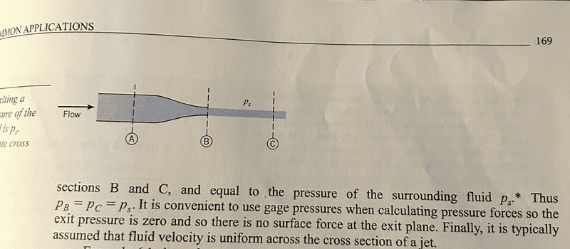

From my textbook, for subsonic incompressible flow the pressure in the jet is constant (atmospheric). The elevation head here in air, negligible. Hence ##v_i=v_o## ,and ##h = \frac{D}{4}##. That feels like garbage in = garbage out.
Under these assumptions the force of thrust from the remains constant, and the puck keeps accelerating if it is sufficient to cause acceleration. clearly, not what is observed. I think the flow is expanding and the force decreasing as in the first problem. the flow is slowing down because of heat generated via inelastic collisions with still gas surrounding the flow.
Or everything is a ghost of assumptions past. Also, a strong possibility. An easy mistake to make no? I'm certainly left with more questions than answers as usual... I'd like to take some time to try and untangle it.
I think it's mainly heat generation that is responsible for the effect here. The flows energy is being shared with the surroundings, its expanding, and the forces doing work on the puck are diminishing with distances from inlet. I also don't believe the total kinetic energy of the flow is lost to surroundings at the position of equilibrium (or oscillation about it).
Specialists in fluid mechanics (I'm just a hobbyist in everything)? @Chestermiller, @boneh3ad , @pasmith , others @jmex ? I'm always excited to take a beating.
EDIT: all my latex turned to unicode...why does it do that sometimes?

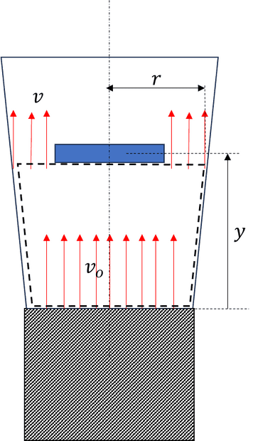

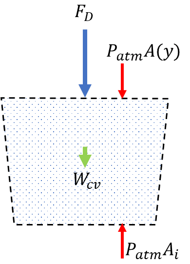

Here is the model I wish to entertain:
Isolate the control volume:

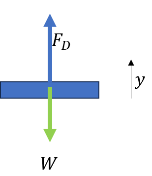

So we have the force of drag acting downward ##F_D##, Weight of air in control volume ##W_{cv}##, uniformly distributed (approximately atmospheric) ##P_{atm}## acting across the inlet and outlet cross sectional areas. The immediate goal is to find the drag force. Also velocities are assumed uniformly distributed across the inlet/outlet. Begin with (1):
$$ \sum \mathbf{F} = \frac{d}{dt} \int_{cv} \rho \mathbf{v} ~ dV\llap{-} + \int_{cs} \rho \mathbf{v} \left( \mathbf{V} \cdot d \mathbf{A} \right) \tag{1}$$
$$ -F_D - W_{cv} -P_{atm} A(y) + P_{atm}A_i = \frac{d}{dt} \int_{cv} \rho \mathbf{v} ~ dV\llap{-} + \int_{cs} \rho \mathbf{v} \left( \mathbf{V} \cdot d \mathbf{A} \right) $$
I neglect the difference in the pressure terms and the weight of the control volume. I am left with:
$$ -F_D = \frac{d}{dt} \int_{cv} \rho \mathbf{v} ~ dV\llap{-} + \int_{cs} \rho \mathbf{v} \left( \mathbf{V} \cdot d \mathbf{A} \right) $$
On to the momentum side of the equation:
Since the mass inside the control volume is taken to be very small, I expect the rate of momentum accumulation within the control volume to be small, hence:
$$ -F_D = \cancel{\frac{d}{dt} \int_{cv} \rho \mathbf{v} ~ dV\llap{-}}^{\approx 0} + \int_{cs} \rho \mathbf{v} \left( \mathbf{V} \cdot d \mathbf{A} \right) $$
$$ -F_D = \int_{cs} \rho \mathbf{v} \left( \mathbf{V} \cdot d \mathbf{A} \right) $$
Next, with the uniformly distributed velocities we evaluate the integrals over the control surfaces:
$$ -F_D = \int_{outlet} \rho \mathbf{v}^2(y) d A(y) - \int_{inlet} \rho \mathbf{v}^2 d A_i $$
Applying continuity ##Q = v_{inlet} A_{inlet} = v(y) A(y)##:
$$-F_D = \rho Q^2 \left( \frac{1}{A(y)} - \frac{1}{A_i} \right)$$
$$ \implies F_D = \rho Q^2 \left( \frac{1}{A_i} - \frac{1}{A(y)} \right) $$
The area of the annulus is given by:
$$ A(y) = \pi ( ky + r_i)^2 - A_p $$
Now apply this to drag force to the puck:
$$ F_D - W = m \ddot y $$
$$ \rho Q^2 \left( \frac{1}{A_i} - \frac{1}{A(y)} \right) - W = m\ddot y $$
$$ \rho Q^2 \left( \frac{1}{A_i} - \frac{1}{\pi ( ky + r_i)^2 - A_p} \right) - W = m\ddot y $$
From here you get the steady state solution for ##y## by setting ##\ddot y = 0 ## and solving.
Now, what seems to be sensible (to me) is this model for the expanding flow area as energy is robbed from it (flow work from drag) in the form of heat.
How can a sensible ##k## be found from first principles seems to be the remaining thorn.
Thoughts?
EDITS: corrected some of the mathematics pertaining to the evaluation of the control surface integrals as well as some careless subscript usage.

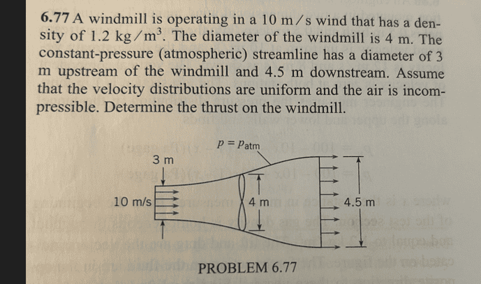

We'll perhaps its more delicate in defining what is causing the loss in flow energy than I stated as "drag", but the fact of the matter there is no lift without viscosity, so I don't think it resolves the issue (I used the term "viscous effects" in #27 several times ). The end result is flow energy is being converted to heat.
What do you make of problem 6.8 in post 24 if you are dissatisfied with the wind turbine? I think it i also a very close relative to the task at hand here as well.

I'm having doubts about static pressure due to two ideas:
1) The pressure in a subsonic fluid jet is atmospheric pressure.
2) Due to (1) its found that in impacting incompressible fluid jet on a vane for example ##v_1=v_2=v## constant velocity. When those problems are solved, the pressure distribution is not integrated over the vane in calculating the reaction force on the vane. Its negligible in comparison to the thrust. The momentum equation (eq1) in post 24 with incompressible flow, and the result of the force falls out. I don't see how this is differs in nature if you are wanting to approach it like this:
If you apply Bernoulli's for incompressible the flow still retains it KE, but changes direction. I think its problematic saying PE = KE. Forget the intermediary (pressure) you can just say ## mgh = KE##. It feels good...until you try to justify the fluid mechanics.
