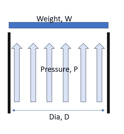

If you use that control volume (though I would draw the outlet to be even with the inner edge of the pipe), you can do an analysis using conservation of mass and momentum. Define the inlet size as station 1 and the outlet under the disc as station 2. Then conservation of mass, assuming steady and incompressible flow, states that
$$\boxed{V_1 A_1 = V_2 A_2.}$$
You know that ##A_1 = \pi D^2/4## and ##A_2 = \pi D h##, where ##h## is the height the cap is lifted. That lets you relate the inlet and outlet velocities. You could start with the integral form of conservation of mass here, but that's a bit much for this case.
Conservation of momentum is a bit trickier, but is how we relate flow quantities to forces. Assuming steady flow and neglecting viscosity and gravity (which seems reasonable if you draw the small CV),
$$\iint_{\mathcal{A}}\rho\vec{V}(\vec{V}\cdot\hat{n})dA = -\iint_{\mathcal{A}} p\hat{n}dA +\vec{F}_{ext}.$$
You can simplify that and you'll find that the ##x##-momentum equation is satisfied by default, so all that's left is the ##y## direction. There, you'll have some pressure at the top of the pipe (station 1), ##p_1##, atmospheric pressure at the outlets, ##p_{atm}##, and the weight of the cap, ##W##, which points down. Simplifying the momentum equation in the ##y## direction yields
$$\boxed{-\rho v_1^2 A_1 = p_{atm} A_1 - p_1 A_1 + W.}$$
If the goal is to get the height the cap lifts, ##h##, as a function of ##p_1## (or more usefully, ##p_g = p_1 - p_{atm}##), then we currently have 2 equations for 3 variables. Enter the Bernoulli equation (again neglecting gravity).
$$\boxed{p_1 + \frac{1}{2}\rho v_1^2 = p_{atm} + \frac{1}{2}\rho v_2^2.}$$
That should allow you to solve for ##h## as a function of ##D##, the pipe diameter, ##p_g##, the gage pressure inside the pipe, and ##W##, the weight of the "cap."
This time I chicken-scratched this during a different meeting, so someone check my work.

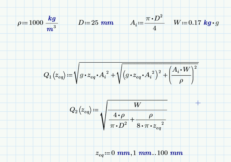

I just looked at my solution and clearly I screwed something up because it predicts flow and a lifting of the cap when there is zero pressure in the pipe. Ha! Looking for where I likely made a typo, probably won't get to it until later.

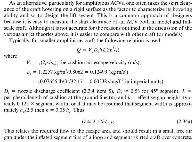

The height of a stationary ACV over a hard surface, is determined by the flow, Q , and the shape of the skirt, which determines the discharge coefficient.
Directed air-jets, below the craft, are designed to reduce the discharge passing below the skirt. Those jets lower the discharge coefficient to about 0.53, which represents a significant improvement over a simple discharge.
The mass of an ACV is supported by the increased pressure below the ACV. That is no different to the disc hovering above the end of a tube. Each, self-adjusts the height, to discharge the flow being provided.
Liang Yun, Alan Bliault - Theory and Design of Air Cushion Craft - Arnold_ Wiley (2000). Section 2.5: "Flow rate coefficient method". Page 72.
Liang Yun, Alan Bliault - Theory and Design of Air Cushion Craft-Arnold_ Wiley (2000).jpg

When I solve the system of equations you suggest I get for ##z## direction:
$$ - W + p_1 A_1 = - \frac{ \rho Q^2 }{A_1} $$
I'm using ## p_1## as gauge pressure ( ## p_{atm} = 0 ~\text{gauge} ## ).
After I sub in Bernoulli's as you've done I get:
$$ Q = \sqrt{ \frac{W}{\frac{4 \rho}{\pi D^2} + \frac{\rho}{8 \pi z_{eq}^2} }} $$
If its algebraically correct, its certainly unrealistic for larger ##z_{eq}## as ##Q## is approaching a constant.
Another concern is if the pressure is significant to the solution here for a given puck, what is the reason it appears insignificant to the solution I propose in 39 and 40. It seems inconsistent.
I think with air, viscous effects dominate; with water, elevation head dominates. Why the pressure would be significant in one, but not the other incompressible flow (treatment) escapes me. Perhaps for the air incompressible assumption is significant stretch? I don't think its right to half-heartedly accept the assumptions and expect to get a consistent result in the framework.
EDITS: reworked the algebra.

In the meantime, let me examine some limits:

$$ Q = \sqrt{ g z_{eq} A_i^2 + \sqrt{(g z_{eq} A_i^2)^2 + \left( \frac{A_i W_p}{\rho}\right)^2 } } \tag{1} $$
When we try to use pressure ignoring elevation head, we get:
$$ Q = \sqrt{ \frac{W}{\frac{4 \rho}{\pi D^2} + \frac{\rho}{8 \pi z_{eq}^2} }} \tag{2} $$
Am I repeatedly making an algebraic mistake to get this? I can tell (2) is behaviorally a poor result. I have graphical /numerical results that confirm.
I don't hope this goes quietly into the night without verification because I am probably going to miss learning something if it does. Isn't that what we are here for?
P.S. sorry for mixing and matching units (I'll edit if anyone is peeved), but readers get the point I hope.

jmex said:
Hello,
I have a circular pipe where there is an inbuild pressure and I have kept a circular weight on it. I would like to know what would be the lift of the weight under certain pressure.
I know the relation that the minimum weight required to keep the pipe closed is F = P*A. (this F will be the required weight to keep the pipe closed.) As there will be increase in pressure, the weight will lift. How do i calculate what would be the lift in case of increase in pressure.
(Assuming that the weight is constrained to vertical direction only)
Thanks
Hello! It seems to me that the following needs to be taken into account in order to perform the calculation. The process you are describing consists of two processes: 1) The process when the load has not yet been lifted (determined by the static pressure of the system); 2) The process when the load is lifted and air flows through the formed free flow section (determined by dynamic pressure). In essence, this is similar to an artillery piece - the projectile in the barrel obeys the laws of internal ballistics, and the projectile that leaves the barrel obeys the laws of external ballistics.
