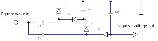

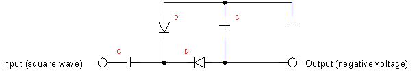

I am not quite sure what you are talking about, but I can at least show how to generate a negative voltage. All it takes is a square wave generator (easily constructed with digital or analog circuitry) and feed it into the circuit shown here. The unloaded output voltage is close to the amplitude of the square wave.
There are several possible variations of this circuit. One interesting variation is as a voltage multiplier - it is possible to get higher voltages if desired (but at the cost of increased output impedance).

Yes, Svein's circuit produces a negative voltage. It is typically called a "charge pump" in the literature. It's quasi-DC as it will have pretty brutal ripple on it (depending on the value of C and the square wave frequency). If a stable voltage is needed it can be regulated or filtered.

In the schematic one of the diodes is reversed and the circuit will only produce about 0.7V output. Otherwise the circuit can possibly double the negative input amplitude if the output common is connected to the generator common. Greater than double the voltage can be achieved by installing more components.

Oops (red face). Corrected circuit follows (with voltage doubler inserted).
Now you have a voltage quadrupler...

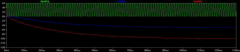

No, it's a voltage doubler. See the simulation below (I used a sine wave instead of a square wave because it was handy).
