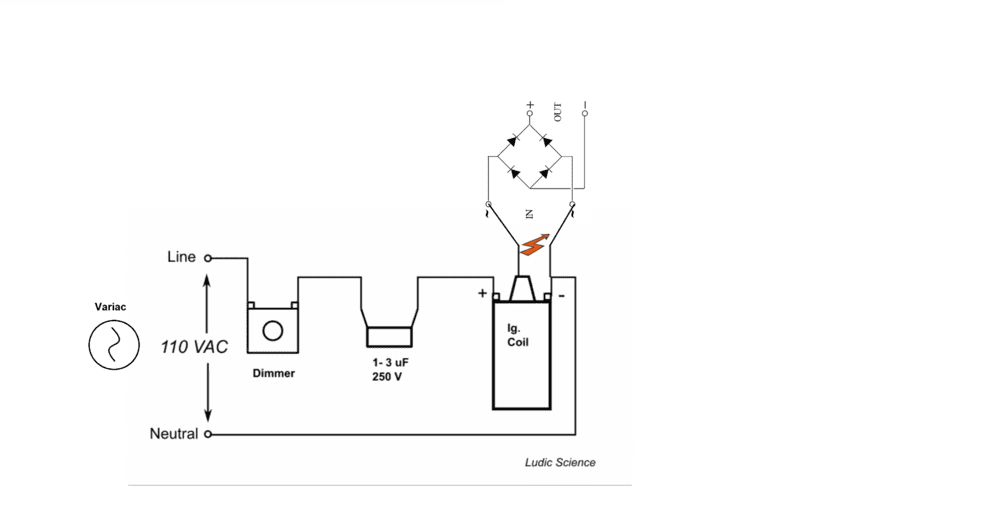

I built a high voltage ac power supply using a YouTube tutorial so I could use it in my parallel plate capacitor experiments. But since discovering that I actually need direct current to charge the plates correctly, the circuit needs to be rectified. I found a tutorial on building a full bridge rectifier out of high voltage diodes, but I was wondering if I could just use a lower voltage rectifier (say 500V) connected to the variac and still get dc at the output.
Intuitively, I'd place the fbr at the output (like in the image below) but I'm not sure what's safer/most efficient. I think I've researched most of the necessary safety precautions and always use high voltage rated safety gloves to operate the circuit as well as a high voltage resistor to discharge the capacitor. All equipment is disconnected when not in use. Any help is greatly appreciated!

That is a very dangerous circuit because it is connected directly to the mains Active and Neutral, without any isolation or fuse.
If the Active is accidentally swapped with the Neutral, the chassis will become live.
If the 3uF capacitor or the dimmer fails short, the current will no longer be limited.
The four diodes at the top right is the rectifier. That is the only place it can be, following the ignition coil = autotransformer.
Does it need a bypass capacitor across the output?
What voltage rating will it need? More than 30kV? What will that cost?
Please don't build and operate that circuit. It may kill you.

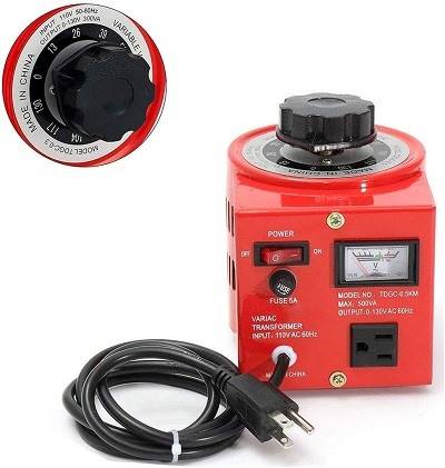

Thank you for the quick response! I'm using this variac model with fuse protection. If it pops all current will drop immediately.
