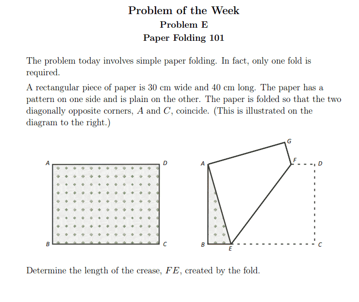

View attachment 6183 So I know that AG is 30cm, what else do I do?

Hey Ilikebugs! ;)
Let's draw some helping lines and attach some variables:

We're looking for $x$... can we find a couple of equations that include $x$? (Wondering)​
uhh I don't know
Well... we have for instance the right triangle $\triangle EFH$ with sides $40-2y$, $30$, and $x$.
How about applying the Pythagorean theorem? (Wondering)
x= 2500-160y+4y^2 ?
Good! (Nod)
Do add a square on the left hand side: $x^2= 2500-160y+4y^2$.
Now how about applying Pythagoras to $\triangle ABE$?
And to $\triangle AEM$?
(AE)^2= 900+y^2 or 625 + x^2/4?
Good! (Nod)
So we have:
$$x^2= 2500-160y+4y^2 \\
900+y^2 = 625 + x^2/4$$
Can we solve $x$ from these 2 equations?
Well I can't
Let's see... (Thinking)
$$x^2= 2500-160y+4y^2 \tag 1$$
$$900+y^2 = 625 + x^2/4 \tag 2$$
Eliminate $x$ by substituting (1) in (2) to find:

Find $x$ now by substituting (3) in (2):
$$900+\Big(\frac{35}{4}\Big)^2 = 625 + x^2/4 \\
900+\Big(\frac{35}{4}\Big)^2 - 625 = x^2/4 \\
x^2 = 4\left(900+\Big(\frac{35}{4}\Big)^2 - 625\right)
=3600 - 2500 +\frac{35^2}{4} = 1100+\frac{1225}{4} = \frac{4400+1225}{4}=\frac{5625}{4} \\
x=\frac{75}{2}
So the length of the crease is $\frac{75}{2}$. (Cool)
Alternatively, using Pythagoras, $30^2+y^2=(40-y)^2\implies y=\frac{35}{4}$.
$(40-2y)^2+30^2=\left(40-\frac{35}{2}\right)^2+900=x^2\implies x=\frac{75}{2}$.
