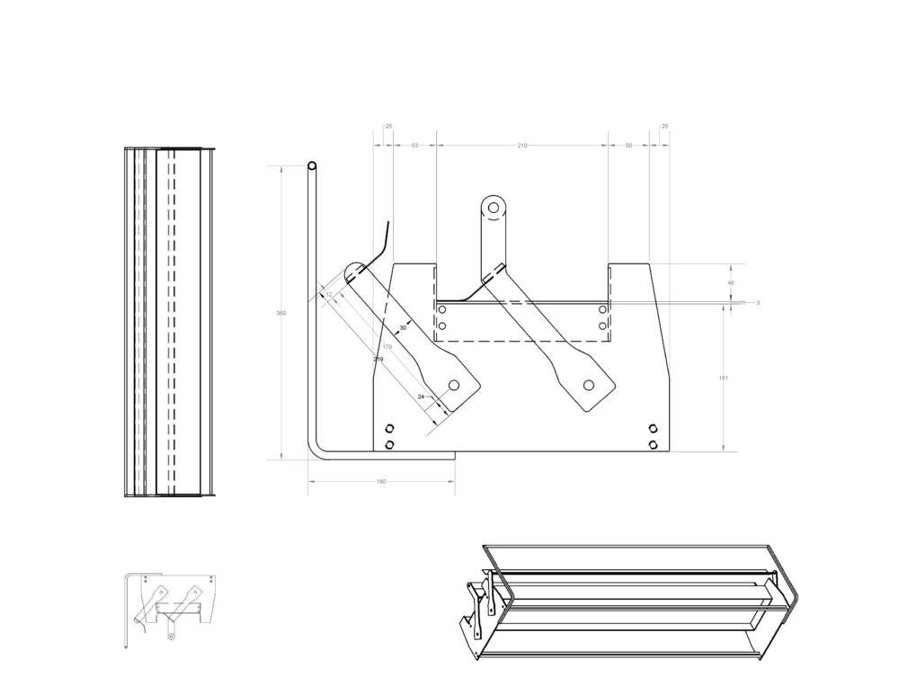

I am trying to replicate a folding machine, just as a fun project for home use.
I understand this simple idea of a folding machine, and I know which measurements I should take.
The question behind this project that I simply can´t understand is the spring linear clamp which holds paper in space. There seems to be a trigger that releases the clamp after it has been streched.
Does any of you understand the idea?
also here is a side image of the folding machine
What are your thoughts on how it´´s made?

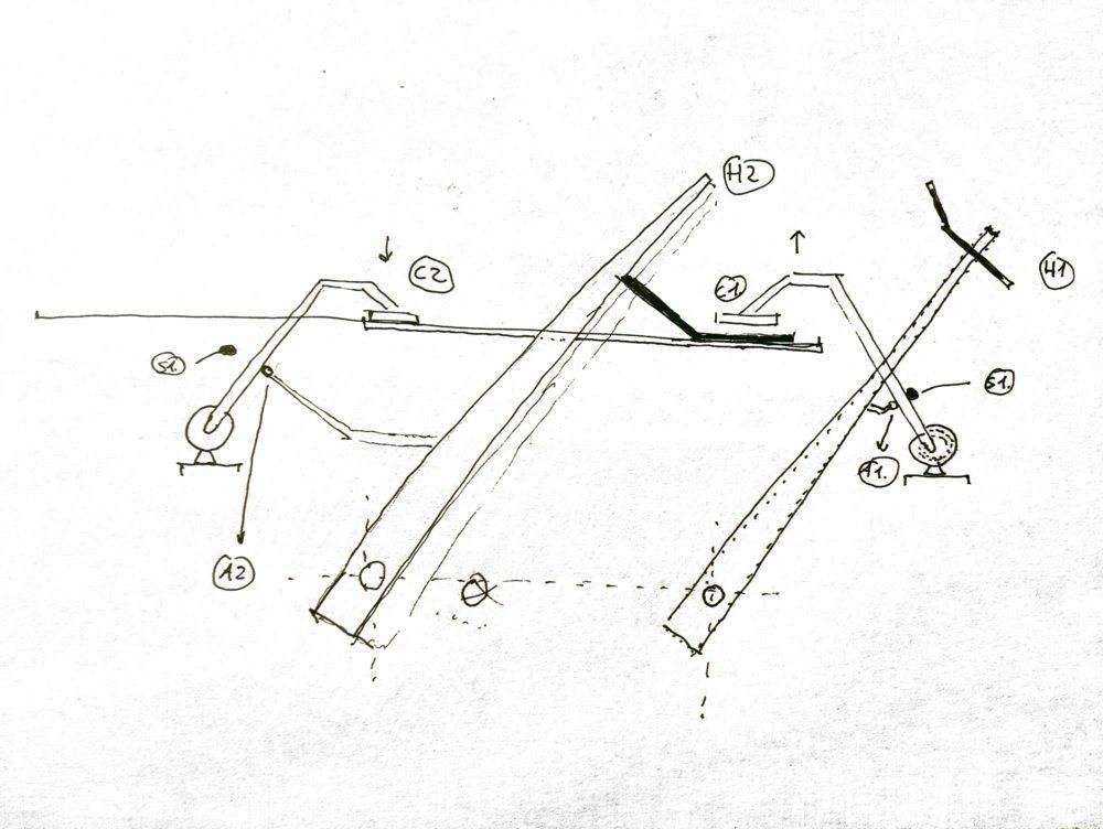

Lever action- one end slides up( or down depending on the linkage ) a ramp at the end of the swing and releases the clamp - probably spring loaded to a give a particular pressure to hold the paper. Reversing the swing let's the clamp clamp down onto the paper.

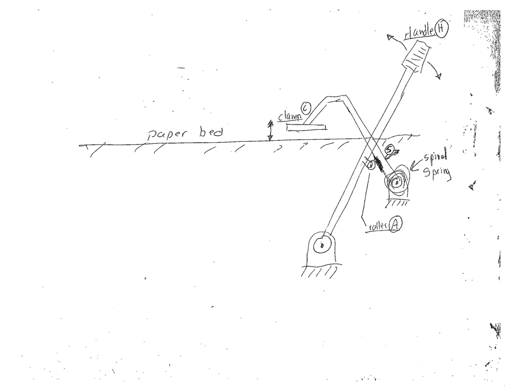

A sketch, freehand, hope you can read it.
Handle H moves back and forth.
At the end of the swing, roller A contacts Surface S, lifting clamp C from the paper bed.
Moving handle H forward, disengages roller A from surface S, allowing the spiral spring to lower clamp C back down onto the paper.
It is just a 2 minute idea that popped up in my mind.
Just be sure you think about and make your own design, rather than follow this one blindly,
There are many configurations, and some would work better than others - ie less wear, elimination of binding of the roller and surface, etc.
You might want to add a stop for the handle at its end of the stroke.

Amazing! Thanks for posting this sketch, and thanks for taking your time for this,.. it is nice to stretch my brains a bit :smile:
Assuming that the two handles - levers are connected and they move synchronously, do you think that on the other side lever should have the roller on the other side.
Also I think the idea of clamp is to hold the paper in place when you push the lever on other side. Doing it slowly would pull the paper out, so there must be some kind of trigger to push the clamp down immediately when the bent sheet of metal is moving away.
As seen on video it seems like this sheet of metal pushes the trigger near the clamp which squeezes the paper.
I know there are thousand of different variantions and that this machine would work without this mechanism, but it got me thinking :smile:

I believe that the unlock knob only releases the connection rod between the two handles and when you put them in outward direction the clamp holds the paper. So when a handle A or B is outward they hold the paper. And altrough the handles are not connected when unlocked it seems that they are still somehow connected, because when the front handle is pulled almost horizontally you can see the other one move a bit and clamping the paper. I will try to dig into this mechanism and do a little 3D print to test it out and of course share with you guys :D

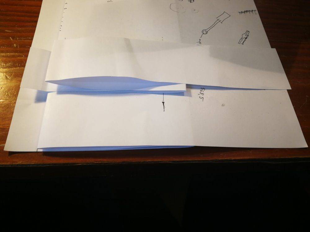

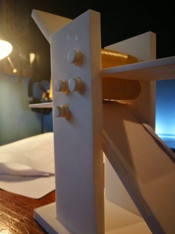

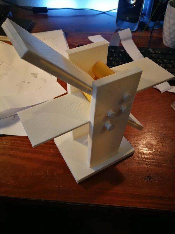

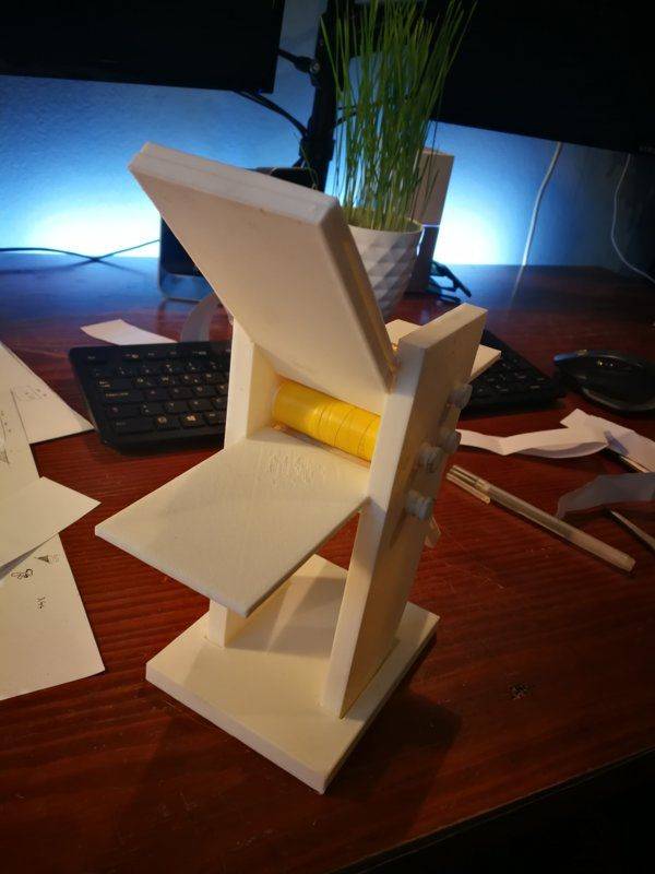

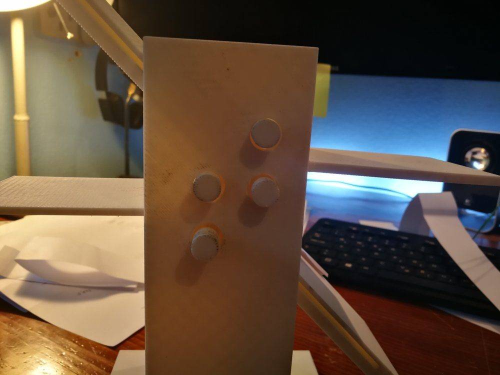

So I found another interesting folding machine, which uses rollers. I made a 3D and printed it with my 3D printer.

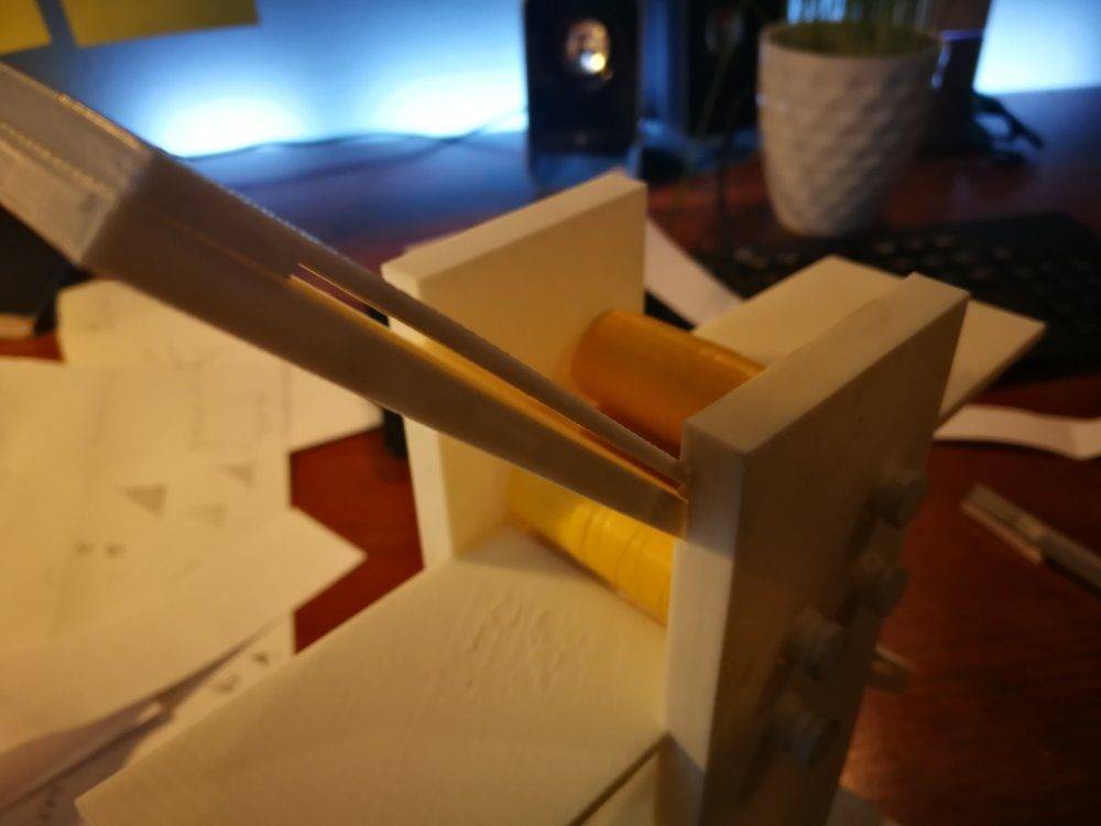

There are two rollers at tge beginning one touching another and then the pattern repeats horizontally after the second one. There are two ramps positioned at the angle of 45°. Ramp has a stop at 125 mm - 1/4 of a roller circumference. The other one is a bit shorter, at 105mm - 1/4 of a roller.
Everything works a bit harsh because of the 3D print quality and rollers don't have a proper rubber on, just a duct tape :) and because I made an offset on parts so that everything could be put together.
All in all it is a simple design and a "cute little machine, but it is only made for A3 length because it makes a single Z-fold. If elwe would like to customize it to more folds it would have to have another set of rollers.
The result is of course a little wrinkled, but hey the measurements were approx. there.
