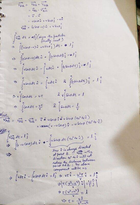

NTesla said:
@PeroK, @haruspex, @Steve4Physics: I've tried to solve it once again. Please let me know if it is correct(Is the reasoning written in lower half of the first pic correct ?):
##\vec{v_{AG}}## is the velocity of particle A wrt Ground. Similarly others.
Something doesn't look quite right to me with the above, because ##\hat v## depends on time, hence you can't take it out of the integrals.
  • #32
I agree, and I very much doubt the validity of the preceding line, where the integral of the component of ##\vec u## orthogonal to ##\vec v## is taken to be zero. That component starts out as directly East (say), then veers to the SE as A swings to the NE. It never has a westward component, so cannot integrate to zero.

  • #33
NTesla said:
The equation that you wrote: ##\int_0^T\vec v.dt=l\hat j+\vec u.T## is right. I understand it.
But I couldn't understand why the 2nd equation(in the original post) was wrong. ##\vec{v}cos\theta## is always in the direction of displacement ##u\tau##.
##\therefore## atleast this equation should be right: ##\int_{0}^{\tau}\vec{v}cos\theta dt=u\tau## should be right. Isn't it ?
Yes, sorry ... it was late here, should have slept on it. Post corrected.

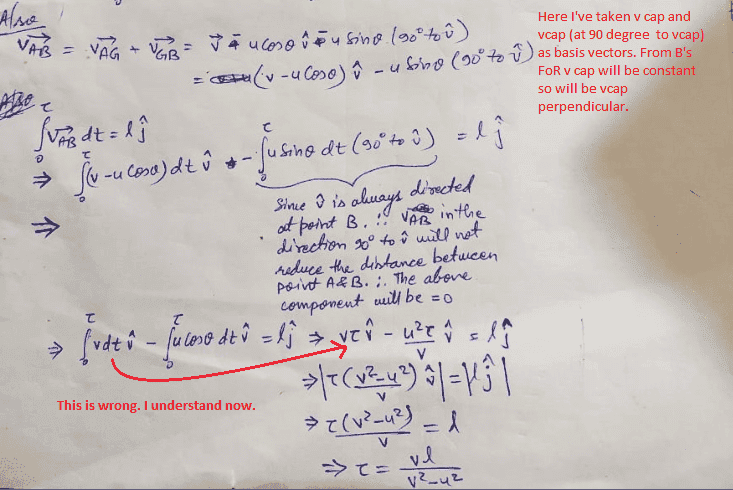

  • #34
##||v||## and ##||u||## are given as constants.
  • #35
Yes but the direction of ##\vec{v}## (which is the same as the direction of ##\hat v##) varies with time, don't you think?
  • #36
Look at the fourth line from the end in the first image in post #28.
##\int_0^\tau vdt\hat v## is turned into ##v\tau \hat v##.

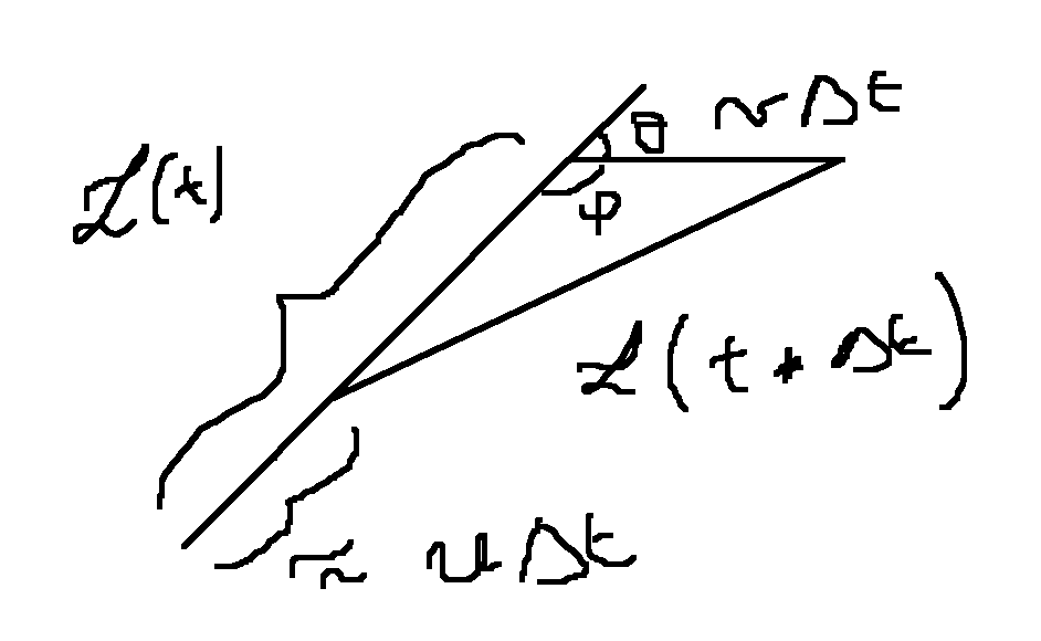

  • #37
archaic said:
I can think of two ways to go about this:
First, by remembering that for the vector ##x## representing the distance between the two points$$||x||'=\frac{x\cdot\dot x}{||x||}\text{ (for any vector)}\Leftrightarrow \int_0^\tau||x||'dt=-L=\int_0^\tau\frac{x\cdot\dot x}{||x||}dt$$but this is too cumbersome to workout, I think.
Second, using a nice diagram showing the configuration at two instances separated by a small period of time, and the law of cosines to find ##||x||'##.
$$L^2(t+\Delta t)\approx\left(L(t)-u\Delta t\right)^2+(v\Delta t)^2-2\left(L(t)-u\Delta t\right)(v\Delta t)\cos\varphi$$Keeping in mind that ##\cos\varphi=-\cos\theta##, we can develop the expression, and manipulate it to get ##\frac{\Delta L^2}{\Delta t}=...##, then compute the limit as ##\Delta t\to0##, and find ##2L(t)L'(t)=...\Leftrightarrow L'(t)=...##
Finally, ##\int_0^\tau L'(t)dt=-L(0)=\int_0^\tau...dt##
The Irodov method is clearly superior. The result follows swiftly from the two equations posted.
  • #38
To get to what PeroK mention in #24, i.e that the relative velocity is ##(v - u\cos \alpha,-u\sin \alpha)## in the basis ##(\hat v,\hat v_\perp)##, we applied a change of basis ##(\hat\imath,\hat\jmath)\to(\hat v,\hat v_{\perp})##. In the new basis, ##\hat v## and ##\hat v_{\perp}## are constant.
  • #39
Interesting you define a frame of reference where the basis vectors are time dependent. This I think means that this frame of reference is not inertial, but I am not familiar at all with all these so I will not comment further.
  • #40
Maybe, but that is not the meaning of ##\hat v## in post #28.
  • #41
In post#28, in the 2nd pic, I've drawn the apparent path of particle A that particle B will observe. ##\hat{v}## and ##\hat v_{\perp}## are constant.
I visualised it as two particles in deep space where there is no gravity, particle A is always targeting particle B therefore ##\hat{v}## is constant and ##\hat v_{\perp}## is also constant. However, as seen in pic 2 of post#28, the path will not be a straight line, but will be curved towards the left, because of the component ##-usin\theta##.
