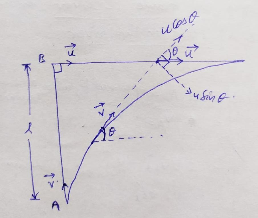

I've added a pic in my original question. Please see it. Once the equation was written, it was just simple calculation, nothing fancy.

But I couldn't understand why the 2nd equation(in the original post) was wrong. ##\vec{v}cos\theta## is always in the direction of displacement ##u\tau##.
##\therefore## atleast this equation should be right: ##\int_{0}^{\tau}\vec{v}cos\theta dt=u\tau## should be right. Isn't it ?

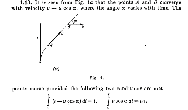

The solution given by Irodov is as follows:
The first equation(in this pic) is what is bothering me. My understanding is the same as haruspex has mentioned in post#11 above, the integral would be the distance covered, not ##l##, the initial separation.
NTesla said:
The solution given by Irodov is as follows:View attachment 276008
You've misinterpreted that integral. The expression ##v - u \cos \alpha## must be the relative speed between A and B. I.e. the rate at which the distance between A and B is decreasing. The integral of which is the change in distance between A and B, which is also ##l##.
That said, I don't immediately see how he gets that expression.

If I may chip-in, I believe the first equation in the pic is simply wrong. The distance covered in the 'y' direction in time ##\tau## is determined by A's y-velocity component. This gives:
##\int_{0}^{\tau}(vsin\theta) dt=l##
That equation is definitely right. But see post #17. Irodov's equation is for the change in distance - although I can't see how he gets it.

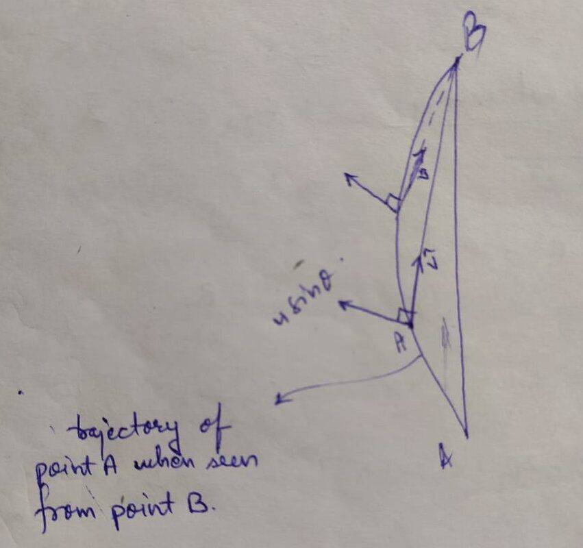

##(\vec{v}-ucos\theta\hat{v})## is the relative speed of point A wrt point B in the direction of ##\vec{v}##. If we integrate this relative speed wrt time, then why shouldn't we get the total distance covered by point A, instead of getting displacement ##l## ?

OK, I'm with you. Maybe the equation comes from consideration of relative velocity. In A's frame, B has an instantaneous relative velocity of ##v - ucos\theta##. That would produce the required integral.

Okay, I see what's he's done. Let's look at the initial situation. A is moving towards B at speed ##v## and B is moving in a perpendicular direction at speed ##u##. The initial separation is ##(l, 0)##. After a short time ##dt##, we have the new displacement of B from A is ##(l - vdt, udt)## and the new distance of B from A is: $$\sqrt{l^2 + v^2dt^2 - 2lvdt + u^2dt^2}$$ Ignoring higher powers of ##dt## gives $$l - vdt$$ In other words, the distance between A and B is reducing at a rate ##v##.
In general, the relative velocity of A with respect to B is ##(v - u\cos \alpha, u\sin \alpha)## and the same applies. The rate of change of distance is the first component only.
Because it's the relative speed. The integral gives the change in distance of B as measured from A. If you were traveling with A, you started a distance ##l## from B and finished zero distance from B. In your frame you are always moving directly towards B. So the distance covered (as measured in your frame) is simply ##l - 0 = l##.
If you wanted the distance actually covered by A, it's simply ##\int_{0}^{\tau}vdt##.

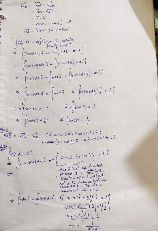

@PeroK, @haruspex, @Steve4Physics: I've tried to solve it once again. Please let me know if it is correct(Is the reasoning written in lower half of the first pic correct ?):
##\vec{v_{AG}}## is the velocity of particle A wrt Ground. Similarly others.
I've also tried this and get the same answer as you (though I haven’t checked your actual working). I found a relatively short/simple method. For info’, here it is (in less-than-rigorous format).
The x-displacements of A and B must be the same during the total time (##\tau##).
##\int_{0}^{\tau}vcos\theta dt =u\tau##
##\int_{0}^{\tau}cos\theta dt = \frac{u\tau}{v}##
From considering the relative motion seen from A’s frame of reference (see previous posts) we know:
##\int_{0}^{\tau}(v - ucos\theta)dt = l##
##\int_{0}^{\tau}vdt – u\int_{0}^{\tau}cos\theta dt = l##
##v\tau – u\frac{u\tau}{v} = l##
##\tau(v^2 – u^2) = vl##
##\tau = \frac{vl}{v^2 – u^2}##
in agreement with your answer.

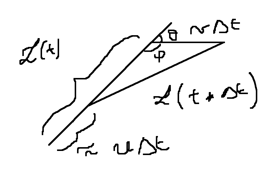

I can think of two ways to go about this:
First, by remembering that for the vector ##x## representing the distance between the two points$$||x||'=\frac{x\cdot\dot x}{||x||}\text{ (for any vector)}\Leftrightarrow \int_0^\tau||x||'dt=-L=\int_0^\tau\frac{x\cdot\dot x}{||x||}dt$$but this is too cumbersome to workout, I think.
Second, using a nice diagram showing the configuration at two instances separated by a small period of time, and the law of cosines to find ##||x||'##.
$$L^2(t+\Delta t)\approx\left(L(t)-u\Delta t\right)^2+(v\Delta t)^2-2\left(L(t)-u\Delta t\right)(v\Delta t)\cos\varphi$$Keeping in mind that ##\cos\varphi=-\cos\theta##, we can develop the expression, and manipulate it to get ##\frac{\Delta L^2}{\Delta t}=...##, then compute the limit as ##\Delta t\to0##, and find ##2L(t)L'(t)=...\Leftrightarrow L'(t)=...##
Finally, ##\int_0^\tau L'(t)dt=-L(0)=\int_0^\tau...dt##
