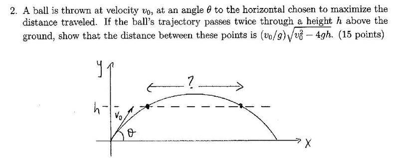

This doesn't seem like much more than a kinematics problem but it's for an upper division mechanics course so I chose to post it here. Feel free to move to intro if necessary.
kinematics equations
I focused only on the vertical component to find the speed at point 1:
V2=Vy2 -2gh
V=√(Vy2 -2gh)
Now I found the time it takes to get from point 1 to the top of the path:
0 = √(Vy2 -2gh) -gt
t = √(Vy2 -2gh) /g
To get from the top to point 2 would take the same amount of time so the total time to get from point 1 to 2 is 2*√(
Vy2 -2gh) /g
Since there's no acceleration in the x direction the distance between the two points is
2Vx*√(Vy2 -2gh) /g
I think this is the correct answer, however I can't get it to match the given solution. Furthermore even if this is correct it seems like it would take a lot of algebra to match the given solution, leading me to believe another approach was taken. Any help?
There was another condition: the distance traveled must be maximized. That means a particular condition on Vx and Vy. Get it, then plug into your equation.
As in theta should be 45 degrees?
EDIT: This would mean the horizontal and vertical components are initially equal making the equations match. Thank you!
Try looking at it this way:
You're probably effectively solving the quadratic equation y=h. The distance between the two solutions is going to be twice the discriminant appearing in your quadratic formula.
Express Vx & Vy in terms of V0. (Use the information in the problem statement.)
