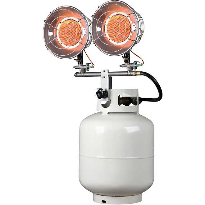

Why not try something like https://www.napaonline.com/en/p/MHTMH32TTC?cid=paidsearch_shopping_dcoe_google_monthly-special_202101&campaign=GSC-Promos&campaign_id=6478906937&adgroup_id=78844950918&adtype=pla&?
etc.

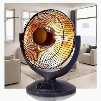

The optics looks all wrong to me. The forward facing part of the red hot area is radiating over about a hemisphere. Not what you want but great for heating a room. You need a way of firing most of the radiated heat into the main reflector and then focusing it onto a small area. Also, turning the radiating element the other way round could melt overheat the holder and the gas pipery.
I can't easily find examples of IR reflectors but there are many websites about microwave antennas which work on exactly the same principle. In this link there is an image of the sort of technique that would be applicable. The arrangement in the first figure produces an 'image' at infinity but moving the (directive) feed outwards will bring the image closer. Easy to do experimentally and not particularly critical if the source is not too extended.
Actually the dimensions of the source are very relevant. The wider the source, the larger the dish diameter required, if you want to avoid spillage. The secondary reflector (and the radiant element too) will block the main beam from the dish but that's a small price to pay for the added 'gain' (directivity) of the system.
I can't easily find examples of IR reflectors...
I assure you the optics are all right! Here’s another example sold at Lowe’s. This produces a fairly concentrated beam. Not sure how strong it is at 50’ though. It’s only rated for indoor use.
Exactly. There would be no point in designing something that would direct all the heat at one patch on an indoor wall. So I have doubts about its suitability.
But that picture is not of the gas heater in the original picture. It's more like the design that I was suggesting but still not suited for a beam of only a few degrees (50' projection range).
