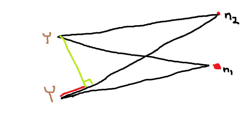

This sounds (unintentional pun) like a double slit problem.
It's just geometry. Draw a diagram of the room. Mark an antinode, say, at distance x from the central antinode. How far is it from there to each fork?
It does sound like a double slit problem.
lodestar,
I think it would help you to recall two things: why there is a node centered between the two forks and the wave equation.

  • Hand-drawn diagram of two sources, each marked with a brown fork symbol, joined by black lines to two red-dotted points labelled n1 and n2, with a green perpendicular line and a red segment on the lower source's line.

Hand-drawn diagram of two tuning forks T1 and T2 at the bottom, each marked with a circle containing an X, with lines drawn from a point at the top-left to each fork, a dashed vertical line between them, and a brace labeled Δ showing the path length difference.
T1 and T2 are the two tuning forks.
The path length difference between the two waves is the distance Δ in the drawing .
Which is (n - 1/2)λ as you mentioned.
