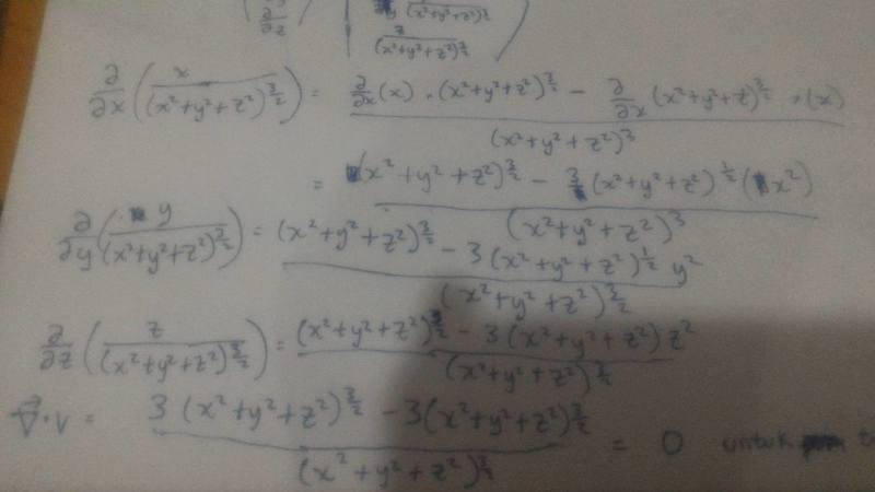

By Gauss' law, how is it able to obtain ## \nabla \cdot \vec{E} = \frac{\rho}{\epsilon_0} ## ?
By Coulomb's law, ##\vec{E} = \frac{1}{4\pi\epsilon_0} \frac{q}{r^2} \hat{r}##
I calculate the divergence of ##\frac{1}{r^2} \hat{r}## and get the result is zero
That means the divergence of ##\frac{1}{4\pi\epsilon_0} \frac{q}{r^2} \hat{r}## is also zero too.
How come it is ## \nabla \cdot \vec{E} = \frac{\rho}{\epsilon_0} ## ?

Your computation is only valid for ##r > 0## where the charge density is zero. The divergence is a delta function at the origin, just as the charge density.

So, what happens at point (0,0,0) ?The divergence is infinity or ##\frac{\rho}{\epsilon_0}##?
The divergence is ##q \delta^{(3)}(\vec x)/\epsilon_0## and so is the charge density/epsilon0. Both are "infinite" at the origin. (The proper treatment is to consider them distributions rather than functions)
