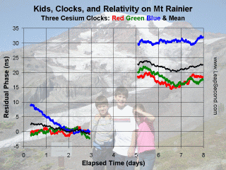

This might be a great time to reintroduce Project GREAT from 2005, wherein a family man took his kids in a camper van to the top of Mt. Rainier, along with a bunch of atomic clocks.
http://leapsecond.com/great2005/
OK, this is GR, not SR, but still...
And, technically, three cesium clocks might count as "laboratory equipment". I guess not all you of have a couple in your kitchen junk drawer.
Alright, that is a cool experiment that would definitely fit the criteria, at least for GR. The main problem here is that I don't have any Cesium clocks, and they seem pretty expensive for the average person (myself included)...
