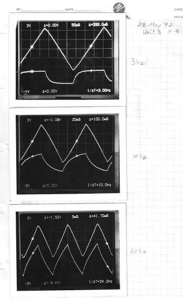

You do remember this old photo
three frequencies, same transformer, with unlaminated steel bar for a core
upper trace in each is primary current, lower is secondary voltage
Handwritten lab notes with three oscilloscope photographs stacked vertically, labelled 3 Hz, 10 Hz and 60 Hz, showing a triangle-wave upper trace and a lower trace that becomes more rounded as frequency rises.
think of it as a low pass filter
mmf of fundamental is passed
at 3 hz, top trace, higher harmonics of primary mmf are passed on to secondary so we get a reasonable square wave over there
.. which is the proper e=Ldi/dt for triangle wave current
at 10 hz , middle trace, higher harmonics are beyond ability of core to pass on to secondary , they're attenuated, so voltage wave looks less squareat 60 hz bottom trace pretty much only the fundamental is passed
from another measurement, above 400 hz this transformer was oblivious to presence or absence of its core
7th Fourier term of 60 hz won't get through any stronger than air core because its>400
but at 3 hz that'd be the 133rd Fourier term. it's late and i hope this makes sense
sorry I'm not more academic
upper trace in each is primary current, lower is secondary voltagethink of it as a low pass filter
but at 3 hz that'd be the 133rd Fourier term.it's late and i hope this makes sense
Jim you always help me keep perspective. Yes a filter is what it is! So I suppose if I was testing a core I could graph the frequency response curve to find the -2 dB point for the type of steel (by varying the frequency of the primary source).

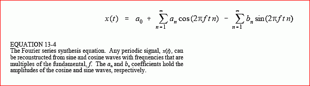

http://www.dspguide.com/ch13/4.htm
Equation 13-4: x(t) = a0 + sum from n=1 to infinity of an cos(2πfnt) minus sum from n=1 to infinity of bn sin(2πfnt), with caption: The Fourier series synthesis equation for a periodic signal x(t) built from sine and cosine waves at multiples of the fundamental frequency f.
DC term is a0
and it's just the average value
Three Fourier series analysis equations: a0 = (1/T) integral from -T/2 to T/2 of x(t) dt; an = (2/T) integral of x(t) cos(2 pi t n / T) dt; bn = (2/T) integral of x(t) sin(2 pi t n / T) dt, followed by a caption defining x(t), a0, an, bn and T.
RMS is per planet math (i expected a √ - i love math but just kicks sand in my face)
Equation for RMS value: F_rms = a0^2/4 + (1/2) times the sum from k=1 to infinity of (a_k^2 + b_k^2).
If you reduce the higher ordered a's and raise a0 to restore RMS
is current changed? Not by an RMS meter i suppose . By a FFT meter or oscilloscope most certainly.
