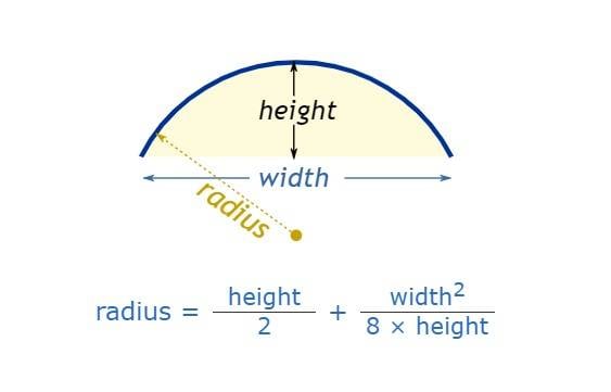

If there is a circle, 360 degrees, and 2 random points A & B are chosen on the circle. A straight line is drawn between those two points. You are not shown the whole circle. All you can see is A, B the straight line and an arc representing an unknown number of degrees. You know the length of the line from A to B. Assuming everything is to scale can one determine the radius of the circle or is more information needed?

No. If you construct the normal on the midpoint of the line, the center of the circle will be somewhere on that normal, but that is all.

That formula exists, it is used in construction.

The situation looks like this:
If you have the arc length above the chord, then we are left with two possibilities. If we have a third point, then we have the circle.
If one knows the sagitta then $$ r=\frac { s^2+l^2} {2s}$$ where ##l=AB/2##

Please, see:
https://www.mathsisfun.com/geometry/arc.html

Known to all grinders of telescope mirrors as the Sagitta Theorem as I mentioned in #8 above. I bring it up because I have corrected my original post from ##~l=AB~##to ##~l=AB/2~## which comports with @Lnewqban result

First: I did not get the fact that you also have got the arc itself, not just the line AB. Second: The formula I quoted above is mathematically correct, but when the height is small relative to the width, the uncertainty in the radius calculation can easily be very large.

Yes when grinding a telescope mirror you use it to calculate the depth of the sagitta required to produce a mirror of desired radius ( and therefore focus) from a circular glass blank. Commonly a "feeler" gauge of some sort is usually created to test "s" the sag depth as you grind (you call it "height"). Because you know l=AB/2 very accurately for the mirror blank the technique is quite precise.
But if you measure l with error ##\Delta l## then$$ r=\frac { s^2+l^2} {2s}$$ $$\Delta r=\frac {\partial r } {\partial l} \Delta l$$ $$\Delta r=\frac l s \Delta l$$ As you have noted

You are absolutely correct; the method is as accurate as the measurements.
As you have seen, the OP just wants a rough estimate so he can shape a sword.
I have seen it used in buildings construction as well, where errors are not that critical either.
The formula for the uncertainty in r relative to the measurement error in l cited above is correct, but my problem lies with the measurement error in s. In that case, you have: [itex]\Delta r=\frac{\partial r}{\partial s}\Delta s= \frac{4s^{2}-2(s^{2}+l^{2})}{4s^{2}}\Delta s = (\frac{1}{2}-\frac{l^{2}}{2s^{2}})\Delta s[/itex] .
