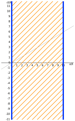

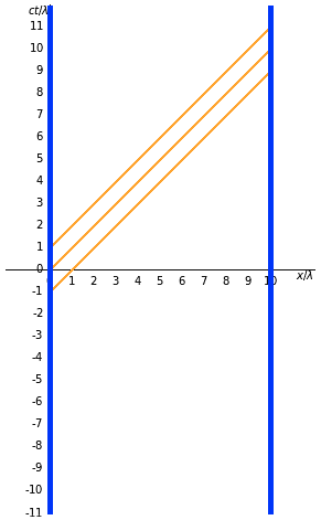

I said above that I'd reasoned about this intuitively - and as I said in @Herbascious J's last thread, Minkowski diagrams and learning to interpret them are, IMO, the key to understanding special relativity.

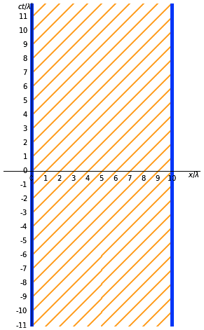

Here's a Minkowski diagram of the train. As always, time is up the page and units are picked so that ##c=1##.
This is drawn in the rest frame of the train. The blue vertical lines are the ends of the train and the orange diagonal lines represent the locations of wave crests as they travel left to right. Along any horizontal line ("an instant of time in this frame") there are always ten waves in flight. This is easiest to count along the ##x## axis where it is labelled, but it is true anywhere - one crest is emitted just as the one ten before is absorbed.
But the Lorentz transform says that ##t'=\gamma(t-vx/c^2)##, and we can rearrange to get ##t=\frac 1\gamma t'+\frac v{c^2}x##. That is, a line of constant primed time ("an instant of time in the primed frame") is a sloped line. We can add the line a frame doing 0.6c calls "time zero" to our diagram - it's the fine grey line.

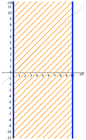

If you count along it, you'll see that it intersects fewer than ten wavecrests - I count four (which will be the Doppler factor squared). So this frame does not see the same number of waves. If you aren't sure you can visualise this in your head you can consider the case where the velocity is very high. Here's 0.95c:

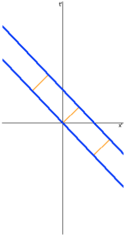

Here the grey line is very nearly parallel to the orange ones, and by considering even higher speeds we can push the grey line closer and closer to the wavecrest passing through the origin. So if you can sketch this in your head, you can quite easily convince yourself that the number of waves must be frame variant.

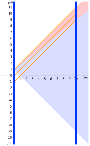

@jartsa raised a point about a pulse of light versus a beam. The above case is a beam - the laser was turned on before ##t=-20## and is still on at ##t=12##, so there is no doubt that in this region all frames agree that the laser is on and the target is illuminated. But you can consider the case where we flip the laser on and off in a very short timescale. That's illustrated here, with just two full waves between three crests:

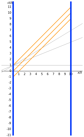

In this case, many frames will agree that there are exactly two waves in flight at once. Here are three grey lines illustrating "an instant of time in a frame" for three frames. You can see that they all pass through exactly three orange lines, so they agree the number of waves:
But, again, we can consider the case where the frame velocity is very high, and the "instant of time" for that frame is nearly parallel (as drawn in this frame) to one of the orange lines. Frames whose definition of "simultaneous with the last wave crest emission" fall within the blue region below see the same number of crests in the pulse; those in the red region see a beam and the number of wave crests depends on speed.
You can see the same experiment in a frame moving very quickly to the right:
Here, the train is moving fast to the left. Consequently it is length contracted and moving nearly at the same speed as light, so the laser emission point is moving rapidly to the left and the reception point is rushing towards each emitted wavecrest, and it is absorbed before the end of the pulse is emitted - so frames like this see something more like the original beam case than the pulse case.
I hope that's helpful. You do need to know the Lorentz transforms to be able to draw Minkowski diagrams, but I found drawing them to be the thing that really made SR "click" for me.
