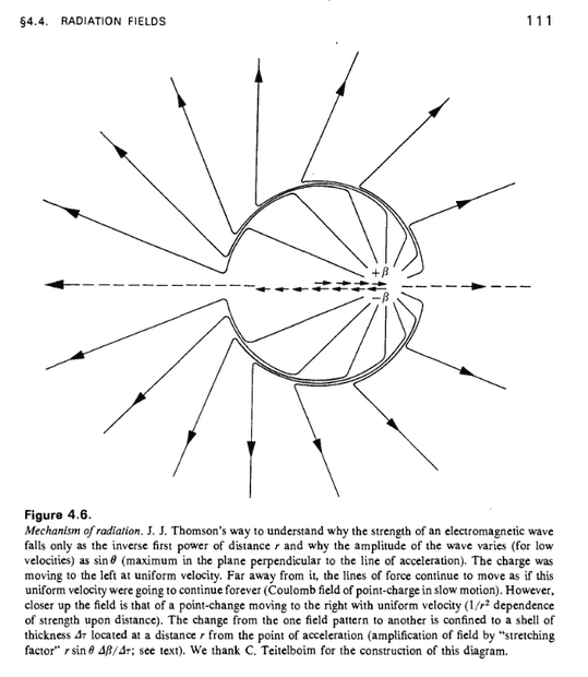

I watched until I found something that was ill-thought out, which starts with his observation about field lines. There's nothing surprising about the field lines of a charge in uniform motion that never accelerates or deaccelrating not changing. If the charge accelerates briefly to change it's motion from "at rest" to moving, there is indeed a "kink" in the field lines that is delayed, as one would expect. MTW has a diagram of this, google finds this diagram reposted on stack exchange https://physics.stackexchange.com/questions/70054/why-do-accelerating-electrons-emit-radiation
The relevant image is:
If I had more patience I might continue to watch the video - but I didn't.
Back to the point I was making - doing a transform to change from a "stationary" frame of reference to a "moving" frame of reference is just a relabeling of coordinates, creating a different view of the same physics. -There is nothing about this process that propagates. You can change your mental image as fast as you like. Physically changing the state of motion of a charge by accelerating it does cause propagation effects.
