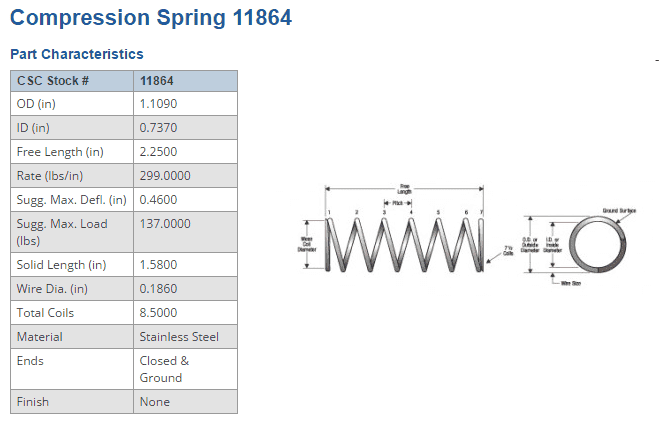

What about using a compression spring in the vise and compress to a known compression distance? It's easy enough to measure compression using a caliper, and so using the spring's spring rate you can determine how much it needs to compress to achieve 100 lbf.
Take for example this spring: http://www.centuryspring.com/compression-spring-11864.html
The above example has a 2.25" free length and 299 lbf/in spring rate. So to achieve 100 lbf, compress it by 0.334" (in series with your part) and voila, 100 lbf compression load.
Likes Chubby Hubby and billy_joule
