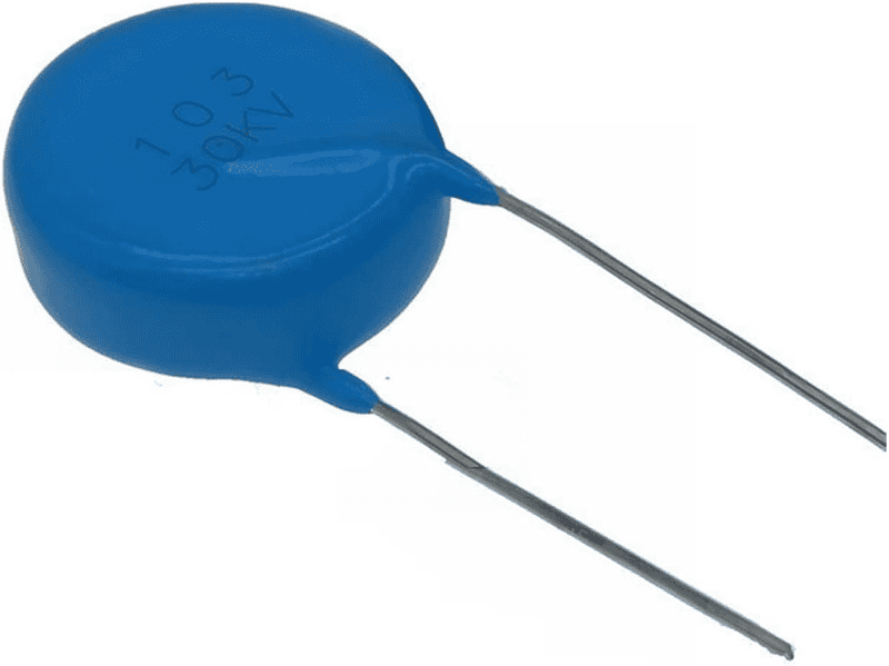

  • #60
Thank you for introducing this useful and informative calculation process.
However, I noticed that doing this experiment can be very difficult and expensive.
Capacitor parameters ##~~~A=1 \text{ m}^2,d=1\text{ }\mu\text{m},V=10\text{ kV},M=1\text{ gm} ##
If I calculated correctly,
the force between the two plates is 445174 Ton-Force
In order to avoid dielectric breakdown of the capacitor, the dielectric material between the two plates of the capacitor can only be a perfect vacuum.. https://en.wikipedia.org/wiki/Dielectric_strength
