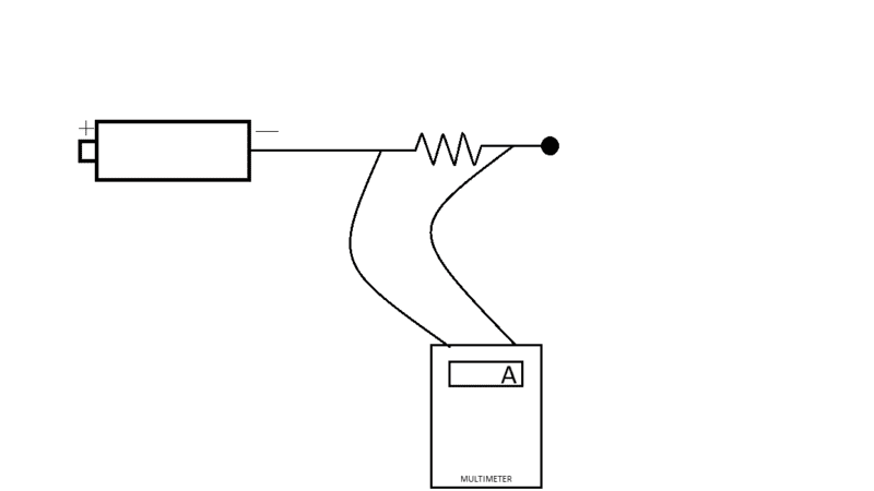

1. I'm changing the question a bit: if we connect the battery to a wire with a resistor and a multimeter to the resistor, in the moment we connect the battery do we see current with the multimeter (current that will disappear after a certain time)? Like in the image below I've made with a highly refined graphic program(Paint).

-1- You've labeled your meter with "A", but an ammeter would be in series with the resistor to measure the series current. As drawn in parallel, you would be using a voltmeter to measure the voltage drop across the resistor to infer the current via V = I*R. And yes, if you used a fast and sensitive enough measurement of the voltage across the resistor, you would see some current flow briefly as the parasitic capacitance from the piece of wire to the right of the resistor back to the battery + end was charged up.

Salmone said:
If I have an open circuit connected to a battery, let's say an alkaline battery connected to a straight wire and nothing more, once I connect the battery to this wire there will be for a short time a current in the wire?
Yes.
Salmone said:
I have this doubt since I know that a capacitor in DC current will charge for a little amount of time with a certain current I flowing in the circuit, is this the same? I think that even a capacitor with only one plate connected to a battery will charge;
That short piece of wire is actually one plate of a capacitor, but of a very tiny value.
The other plate is everything else in the Universe, and the value of a capacitor is proportional to the size of its smallest plate and inversely to their separation (Area/Distance).
The "very tiny value" arises because the surface area of the wire is small and most of the Universe is so far away.
Hope this helps!

p.s. Strictly speaking, there is also some capacitance between the wire and the other battery terminal too.
