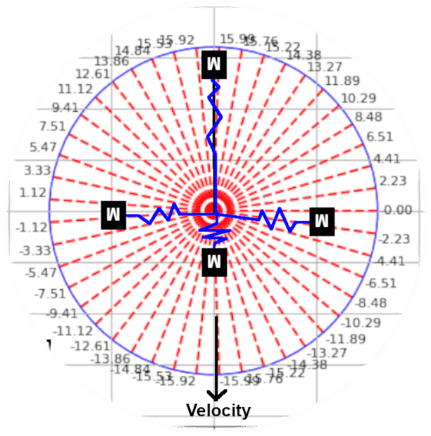

If an accelerometer is rotating as it moves forward through the air, what force is acting on the accelerometer? Say we remove gravity and just concentrate on the horizontal axis.
I know there is centripetal and tangential acceleration that shows up as an offset in the sin wave, but what causes the sinusoidal pattern?
For example if the accelrometer was in place and rotating at a constant speed, all you would see is the centripetal force as an offset. Tangential acceleration would be non existent since the speed is constant.
As soon as it moves forward though, you see a sinusoidal pattern emerge.
The only thing I can think of is velocity of the accelerometer is somehow effecting the readings as it spins. Is this what is happening?
If so, is there math/physics to back this up? Like could you reverse engineer the values to get the velocity?
Say:
we remove the offset so that the centripetal acceleration is not a factor.
ω = ~70 rad/s
period = ~0.09 seconds
amplitude = ~20 m/s^2
we’ll just say phase is 0 to make things simpler.
What would be the math to figure this out? Any help would be very appreciated.

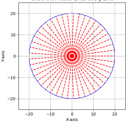

I’ve attached an image of the 2d plane if that helps. There is no acceleration when the accelerometer is 90 degrees to the velocity direction. And negative values from 90 to 270 degrees.
I may have said that wrong now that I look at it closer. Maybe the larger values are on the sides closer to the 90 degrees. I would still love help with this. Been thinking about it quite awhile now. :)

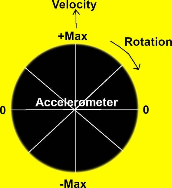

Lnewqban said:
Like in this case?:
The accelerometer is set to sense only horizontal accelerations of the geometric center of a flying Frisbee disc?
Yes, that is a good analogy. The accelerometer is aligned with the radial axis. (AKA: aligned with the centripetal axis). Sorry if I am not explaining this clearly enough. Here is a chart with real world data. I took the data and removed the offset (Which I believed was the centripetal acceleration. (I don't know what else would cause a constant offset.)).

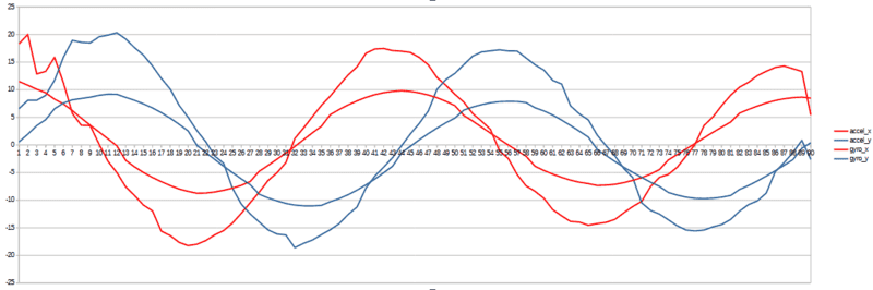

Then I fitted a sin wave to the data. The accelerometer is almost center, but as berkeman mentioned it is not perfectly center. Using the equation ac=ω^2⋅r, I get that R = 0.001103m (So the accelerometer is about 1mm from the center of rotation). In my new diagram I have the velocity vector pointing in the direction I believe Nugatory described where the negative values are aligned with the velocity vector. Once the Centripetal acceleration is removed isn't what is left related to linear velocity?
BTW, Thank you berkeman, Nugatory, and Lnewqban for taking the time to help me with this. I appreciate you!

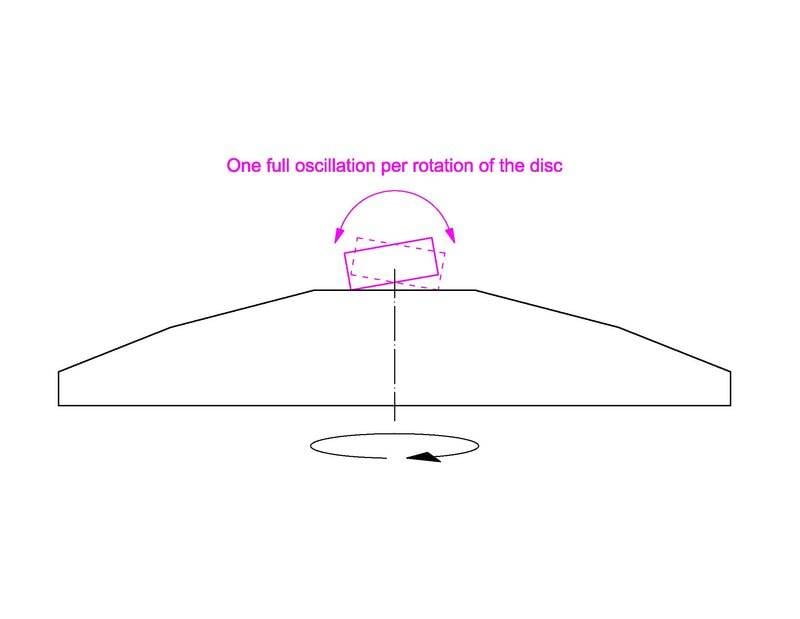

Since the values of accelerations seem to be perfectly symmetrical about the y axis, the radius is only 1.1 mm, and the rpm are only 700, I initially thought about partially blaming the cyclic readings to the accelerometer sensing device not being perfectly coplanar with the disc.
But, after a second, I realized that the readings are respect to the disc rather than to an inertial frame.
Then, I contradicted myself remembering that a small gyroscope fights back any attempt by an exterior torque to change its spatial plane of rotation.
Love the brain storming! I actually attached a 3 axis accelerometer, but want to keep things simple and just think about the linear velocity. However, just for info sake, the z axis pointing down actualy has roughly twice as fast of a rotation. X and Y are similar since they are about 90 degress out of phase.

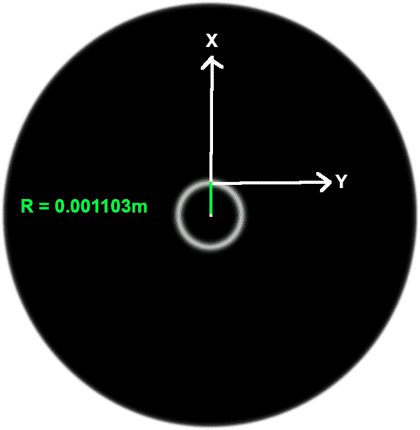

Nugatory said:
The three axes of your three-axis accelerometer are of course the cartesian x,y,z axes and it s reporting the components of the proper acceleration vector in cartesian coordinates. Calculate the components of the centripetal force vector and you will see that you are getting exactly the expected acceleration in the x and y directions. The z oscillation will not be present in the idealized system you described in the original post - likely you are seeing flutter or some other artifact of imperfect balancing of the disk.
I am not totally sure the R value to calculate the centripetal force. I only derived it from the calculation based on thinking that the offset was the centripetal acceleration.
If I understand you correctly your saying the whole thing is centripetal acceleration and the linear velocity has no effect on the measurement? Is the answer to the question no you can not calculate linear velocity from a rotating accelerometer?

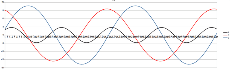

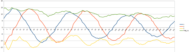

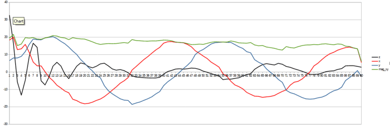

I took the magnitudes of the x and y and got the following plot. It looks like the z axis shows up in the magnitude. (This is the raw data, with the offsets removed).
Here is another sample for comparison. Different amplitude. ω = 62.8318530717959

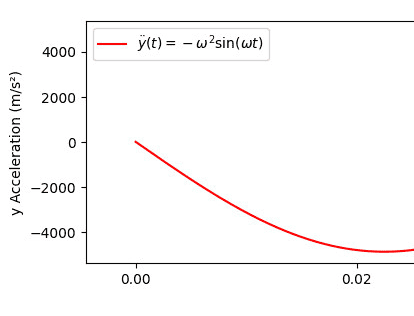

Could this sin wave be due to the deceleration of the disc caused by drag? If you knew the coefficient of drag, could you figure the velocity?
The sine wave has nothing to do with drag, or anything else except the centripetal acceleration produced by the centripetal force. You may be confusing yourself by thinking that the centripetal acceleration is constant - it is not. Its magnitude is constant, but being a vector it has both magnitude and direction, and the direction is not constant.
The sine wave is just how all circular motion works. Consider an accelerometer moving counterclockwise in a circle of radius ##R## with angular velocity ##\omega=\frac{v}{R}##. Using ordinary Cartesian coordinates with origin at the center of the circle (an arbitrary choice that makes the math easier) and starting our clock as the object crosses the positive ##x## axis (another arbitrary choice that simplifies the math) the ##y## position of the particle at time ##t## is ##y(t)=\sin\omega{t}##. We differentiate twice to get the acceleration along the ##y## axis ##\ddot{y}(t)=-\omega^2\sin\omega{t}## and there is the sine wave that your accelerometer is reporting, caused by the centripetal force that is keeping the accelerometer on its circular trajectory. (We can of course do a similar calculation with the ##x## position to find another sine wave, this one ninety degrees out of phase).
Now consider the whole rotating disk moving in the positive ##y## direction with constant speed ##V##.
We use the Galilean transformation to calculate the ##y## position, and we get the rather unsurprising result ##y(t)=Vt+\sin\omega{t}##. Differentiate twice to get the acceleration in the ##y## direction and we get... the exact same ##\ddot{y}(t)=-\omega^2\sin\omega{t}## because the only acceleration involved is that produced by the centripetal force.
(Sorry, I think my attempt so simplify with constant speed made things more complicated. :/)
No, it is less complicated The variable speed problem is worked exactly as above but with the additional complication that ##V## is not a constant but instead some more or less messy function of ##t##.
As I said in the previous post, you do not want to take on this more complicated problem until you clearly understand how the logic of the Galilean transform applies in the simpler constant velocity case.

Orodruin said:
This explanation requires the accelerometer to also be a gyroscope such that its axes remain fixed. This is not the case for most accelerometers. Instead, they are usually fixed to an object (like a smart phone), meaning the reported axes co-rotate with the object. In the ideal case with the accelerometer performing perfect uniform circular motion, it would therefore report a constant acceleration in the radial direction.

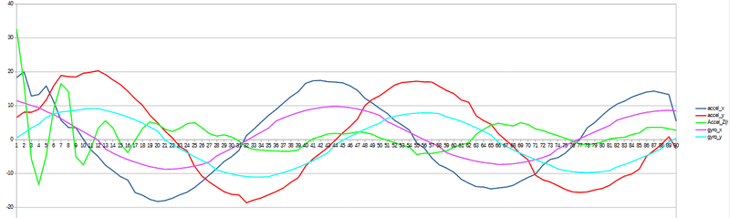

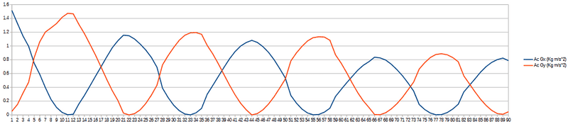

I plotted the 2 graphs as I undertand it. Here are the plots according to how I understood Nugatory's explanation.
And the plot according to how I understand Orodruin's explanation if the accelerometer is aligned with the radial axis.
Correct me if I am misunderstanding. (Learning lots! Love all the help!)
You are understanding them right.
The plots from your posts #13 and #14 show the sinusoidal pattern, so we know you are using an accelerometer that includes the gyroscope @Orodruin describes in his post. Without that gyroscope the accelerometer would have no way of knowing that it is pointing in different directions at different times (rather like “down” on the other side of the earth from us is pointing in the direction that we call “up”) and you would have seen the straight-line plot of your second graph.
