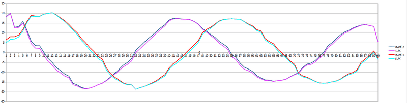

That makes sense. I am going to try and model this but need to make sense of the data. It looks like from the model in the video that the foot of the bear (logo) is pointing down on the right side and then pointing up on the right side so there must be a rotation around the axis. (Like the video says.) The orientation of the sensor according to the datasheet is as the following diagram shows.
I guess when the x axis (gyro) rotates it would effect the linear value of the y axis (accelerometer) which would be 90 degrees out of phase. And the Y (gyro) effects the X (accelerometer).
So I guess the linear accelerometer would just get a centripetal force acting on it from the rotation? But offset also somehow needs to be accounted for.....

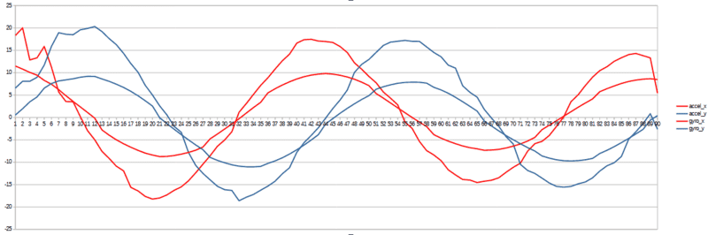

Ok, so I've been working with the data and the wobble does not seem to contribute a lot to the accelerometer values. I used a fairly large value for the z offset from the center of rotation. (A value of 13mm). I take the gyro value (in rad/s) and calculate centripetal acceleration using this formula.
Where 'w' is the gyro reading and R is the 13mm. This gives these values for the centripetal acceleration. (Which is only 1.4 at the highest and 0.8 at the low end.) Am I missing something?
Ignore the units in the chart, thay are in m/s^2.
Here is the original data plotted against the data with the centripetal acceleration from wobble removed. (Very little actual difference)
The Z-accel-component variation, with the double frequency, was supposed to be due to the wobble. You are plotting only X & Y now. What is your point here?

FGD said:
I take the gyro value (in rad/s) and calculate centripetal acceleration using this formula. View attachment 349808 Where 'w' is the gyro reading and R is the 13mm. This gives these values for the centripetal acceleration. (Which is only 1.4 at the highest and 0.8 at the low end.) Am I missing something?
If the XY-accel are in the body fixed frame, then centripetal acceleration is the constant offset, while the sinusoidal phase shifted variation is the external aerodynamic force.
What is "centripetal acceleration from wobble"? Centripetal acceleration comes from the spin, while the wobble modulates the external aerodynamic force.
Yes, this is plotting the X, Y axis. All of the plots in this post are mostly from the same data so as to keep things consistent. As Z wobbles, so does the rotation around the X, Y axis. I am testing the conclusion that the sin wave in the accelerometer X, Y data is due to the wobble. In post #41 it shows the gyro and the accelerometer data. I'll repost so you can see the Z value for the accelerometer as well. (The Z gyro is saturated, so the value is useless and not shown in the plot. But the Z accelerometer is good and shown in green below.)
Just to make sure I understand: You used the (small) XY-gyro values (from wobble) to calculate the centripetal XY-accel due to wobble only, and substracted that from the XY-accel data. That makes sense. And it also makes sense that it's just a minor difference, because the XY-gyro are small.
It's a pity that Z-gyro cannot be used, because that would be the best way to compute and remove all the centripetal linear acceleration, from spin and wobble. But you can remove the constant offset of the XY-accel so it is centered around zero, as you already did. But note that it is not really constant, as the spin slows down over time due to drag. So you should do it step-wise.
