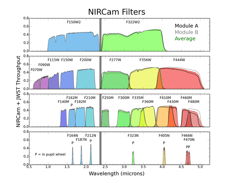

So when photons hit the JWST NIRCam sensor, some of them are absorbed by kicking electrons from valence to conduction in the photodiodes and others of the same wavelength are absorbed without kicking the electrons to a different energy level (the percentage of photons of a certain wavelength that do elevate electrons is known as the quantum efficiency).
Are both forms of absorption considered heat transfer considering the former case leads to a charge building up in an in pixel capacitor in a typical CMOS imaging sensor?
“An MOS capacitor is integrated in a pixel and accumulated charges in a photodiode are transferred to the in-pixel capacitor multiple times depending on the maximum incident light intensity”
https://www.ncbi.nlm.nih.gov/pmc/articles/PMC6479534/
PS This shows the quantum efficiency for NIRCam factoring in various filters:
Chart titled NIRCam Filters plotting NIRCam plus JWST throughput against wavelength from 0.5 to 5.0 microns for Module A, Module B and their average, with filter bands labelled F070W to F466N.
