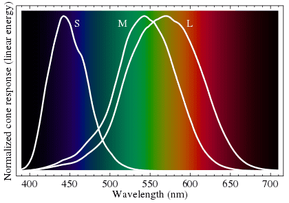

More specifically, the reason we can't see infrared is because our retinas have cone cells with proteins that are sensitive to a small range of the spectrum, and they are not stimulated by light in the IR range. (off the right side of the graph - wavelengths > 750nm):
https://en.wikipedia.org/wiki/Color_vision
This explains why some animals can see in other parts of the spectrum - they have different proteins.
