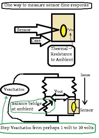

Ten microseconds isn't much time for heat to flow into or out of a sensor..
In my power plant the fastest temperature sensors we had were platinum RTD's with 1 second response time constant
as measured by plunging into a water bath , measuring time to reach 63% of final value.
Some bright fellows on a university research project figured out that they could equally well use self heating of the RTD to measure its time constant .
They took control of the sensing current and applied a step change to it, recording what temperature it reported.
As the element established heat conduction out to ambient they measured and plotted its temperature versus time.. Of course it heated to some few degrees above ambient.
Knowing how much power they were putting in, that let them estimate its thermal mass and its thermal resistance to ambient.
Their first experiments used a simple Wheatstone bridge to provide sensing current to the element. .
The same approach could work with a thermistor.
With low excitation voltage you balance the bridge so it gives zero output
Then suddenly increase the excitation voltage.
As the sensor self heats due to increased sensing current , the bridge becomes unbalanced and gives a voltage output.
The hard part was finding suitable resistors from which to make their bridge. They must have very near zero temperature coefficient else they too will change value when you change excitation voltage.
We loaned them some General Radio precision resistance boxes with manganin wire-wound resistors inside that were quite stable and worked well.
Their other problem was common mode voltage interference from a line operated power supply.
Its power transformer wasn't shielded so interwinding capacitance coupled objectionable 60 hz noise into the bridge and it upset their differential amplifier.
We jury rigged a supply from 6 volt lantern batteries to cure that problem.
Keep in mind that for us one second was a doggone fast sensor. They were immersed directly in the flowstream to avoid the thermal inertia of a thermowell. .
If you're really interested in microseconds of response time then you're in a different league than me.
But maybe something above will help you come up with an approach
Try starting with maybe 1 milliwatt in your sensor and double it.Good Luck !
old jim

Thanks for the links all. They've been very helpful. The idea of making a temperature impulse by moving from one bath to another, as Amphenol did, really demonstrates how slow thermistors are. I expected a thermistor to be too slow for this experiment, and I am a bit surprised as to just how slow thermistors are, but the diode worked reasonably well, although we did not hit 10uS resolution target at no attenuation.
The experiment I did to confirm the thermal bandwidth of the system was: Couple a diode (it's DFN1006, roughly 1mm on a side, so think very tiny) to the circuit element under test and force a constant forward current through the diode. Force another very slow sine of current, with known safe pp magnitude and offset, through the element under test. I used T=300S, which I am confident is inside the channel's bandwidth. With the setup in a thermal chamber with known Ta, observe Vpp on the diode and determine Tpp from it (I curved traced this diode in the chamber at a few temperatures, so I know the diode equation parameters for this part). Call that Tpp=1. Decrease T on sine until Tpp=0.7. That T determines the 3db frequency of the system and I got frequency just under 10KHz. In the experiment, I'll still sample at 10uS as previously planned, but naturally, the signal will be significantly attenuated at that sample rate which is a good thing from a DSP point of view. We will have to make due. :)
I was also thinking some kind of IR measurement could be interesting but I'm not sure how I could make it work as everything is very small and I wouldn't want to mess with lenses.
Jim, the experiment in post #5 is very clever, and I like the approach. Thanks for sharing!
