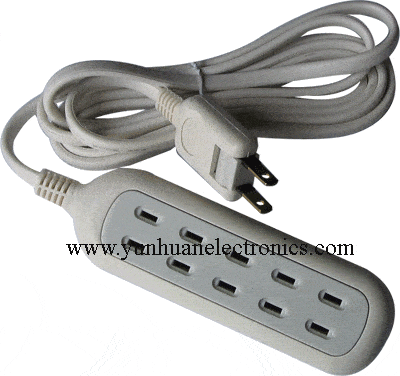

I am referring to this:
A brainwave hit me and I wondered the following:
If the moment when i unplug or switch it off (In my country they have a switch for added safety reason), the live wire happens to be at the peak of the AC curve, will my extension cord effectively become similar to a charged capacitor, with the live and neutral rails at different potentials?
That means to say, if someone opens up the thing, he may get a nasty shock?
Whether it is connected or not, there is never any excess charge in an extension cord.
why issit so?
Power cords carry current, they do not normally become appreciably charged.
There is NEVER "excess charge" in an electric cord. If the cord is attached to a battery (direct current) we have a potential difference causing electric charge (electrons) to move into one end of the cord and out the other. If the cord is "plugged" into and electric circuit (alternating current) we have elctric charge (electrons) moving back and forth very rapidly. In either case, it is the motion of the charges that causes the current and does "work", not "excess charge".
The answer to your first question is yes. If you disconnect an unloaded extension chord from an outlet, the two wires in the extension chord will form a capacitor, storing a voltage equal to the voltage across the outlet terminals when the chord is disconnected.
The answer to the second question is no, for two reasons. The first is that the value of the extension chord capacitance is very small due to the significant distance between the wires. This means the chord can only store a very small amount of energy, probably too small to be noticed if someone were to touch both terminals and discharge the capacitor. The second reason is that the charge stored on the capacitor will quickly leak away due to the finite resistivity of the wire insulation.

It is possible to model a pair of conductors as a parallel RC circuit to get the stray capacitance and leakage resistance. If you do that then because of the very small capacitance you will find that the time constant is also small, meaning that it quickly discharges whatever charge it might have had.

A mains cable is a capacitor and it will charge and discharge in each cycle of current, just as any other capacitor will.
Post #6 is therefore correct.
The capacitance is around 30~50pF/m for 13A mains cable (like kettle cord), higher for smaller lower current cable.
Therefore, if you were to [theoretically] disconnect* a 1m worth of 3A cable at the instant of the peak of a 230V RMS cycle, you'd have 325V on, say, a 100pF capacitor = ½.100x10-¹².325² = 5μJ.
*(both disconnecting the load on the other end of the wire, and then isolate the lines from the mains)
5μJ wouldn't hurt a fly. You likely generate more static electrical energy pulling your shirt off!

Yes, circuit theory is a simplification of Maxwell's equations. It is the primary theory used for building most modern electronics. Circuit theory relies on 3 assumptions:
A) The system is small enough that the finite speed of light is not important
B) The net charge on every component in the system is always 0
C) There is no magnetic coubling between components
To a very, very good approximation the power cord follows circuit theory with the simple model (1) that I described above in post 17. Nobody will "get a nasty shock" by opening the case and shorting the wire.
With rather sensitive equipment and carefully controlled experimental set up you may be able to detect the difference between the simple circuit theory model (1) and the more complicated circuit theory model (2). I don't know that you could ever detect the difference between (2) and the full Maxwell's equations (3).
