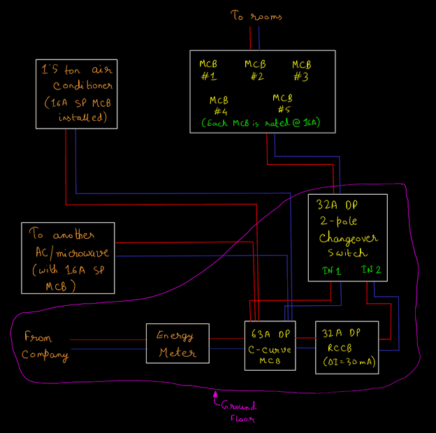

We have a sanctioned load of 63 A from the electricity supply company (AC RMS 230 V in my country). We have, however, not yet been able to upgrade our 45 A main fuse. Due to this constraint, we cannot run more than one high-current-drawing appliance simultaneously, like two air conditioners or one AC and one microwave. We are planning to upgrade the fuse and install a 63 A DP MCB.
I want to also install a 63 A DP RCCB after the MCB for better protection. Preferably one with ΔI = 30 mA. But I think I read somewhere (can't find it at the moment) that RCCBs may trip falsely when induction motors like air conditioner compressors are in series with it. It was written that induction motors draw a large current when they start, which can be detected by an RCCB as an imbalance between the live and neutral currents, thereby making it trip. Is this true?

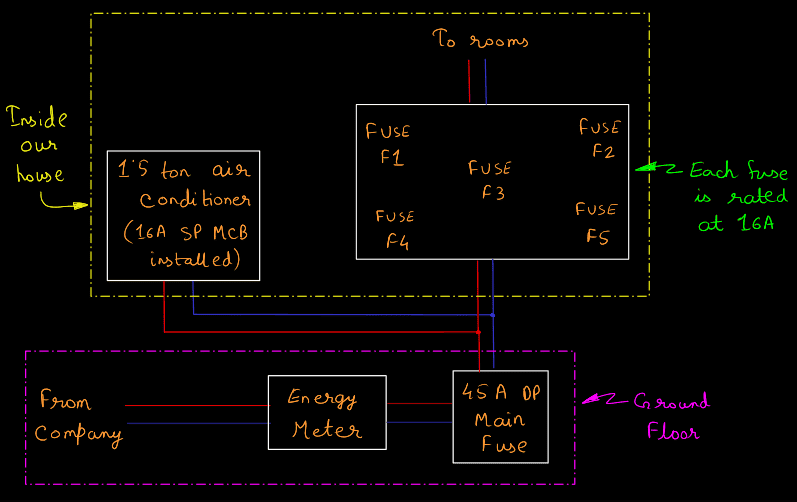

This is how the wiring is done in our house at the moment:
And this is the design I want to implement:
The only purpose of the changeover switch is to make sure that if the RCCB trips falsely, power can be restored without spending a night in the darkness. Of course, passing even the large appliances though a higher rated MCB is what I wanted initially, but that may actually not be possible in the end.

Good idea. For that, I will have to install an RCCB inside the house and do some rewiring. Doable. I will think about it.

Theoretically, yes, it would be possible to do that. That is indeed what should be done. But, that would increase the costs quite a bit. I will keep it in mind.

Upon further thought, it appears that separating the low current devices and the outlets will actually require a lot of rewiring. In the switch boxes in each room, the outlets are attached to the lights in parallel within the switch box itself, so we would have to draw long wires from the fuse box to isolate the outlets. Now, last time we wanted to add an outlet at a different place for our convenience, the electrician found that many of the conduits within the wall were mistakenly cemented when the house was built. Therefore, in many places, we would have to draw external wires. That's going to be one hell of a job. We will keep space in the main fuse box inside the house, but for now, I need to think of a plan that allows me to install an RCCB.

After some further thoughts, I think I have two plans to replace the 63 A RCCB with:
  1. Two 40A RCCBs — one for the lights, and one for all the heavy load appliances.
  2. Two 25 A and one 40 A RCCB — two 25A ones for the low loads, and one 40 A for all the heavy loads.
#1 will be less costly, but #2 is preferable in theory because the whole house won't become dark due to a single tripping.
