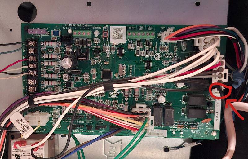

UrbanFarmEngineer said:
Looked inside the furnace and saw it wasn't grounded inside the junction box where the main power supply enters: DID that and most of the stray current disappeared
Can you say more about this? Who installed this furnace? Do you have a copy of the Service Manual or Installation Instructions for this furnace? One would think that the wiring to the house AC Mains would be covered by those documents.

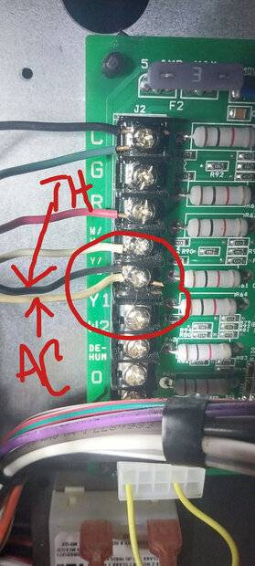

Let me take some pics. I don't use a mobile phone so I will have to get a friend over that has one and take pics to better express what I am saying.
When the HVAC guy came over to fix the valve, I put everything back exactly to how it was so they couldn't say that I "voided the warranty" by altering the unit and when I pointed out the ground wire not being connected to the ground lug/ground screw (again sorry if terminology is wrong let me know if I need to explain better) the HVAC guy looked shocked/panicked and immediately attached it.
I think that it is what @Averagesupernova was saying, just negligence.
The Furnace is a York TM9V Series. Here is the installation manual. It says right on the diagram "Connect ground lead to screw" inside the electrical entry junction box...dang.
I don't have any explanation for that one except that the installer didn't do it..
Okay, that makes sense. No idea why the initial installer missed that, but glad it's fixed now.
