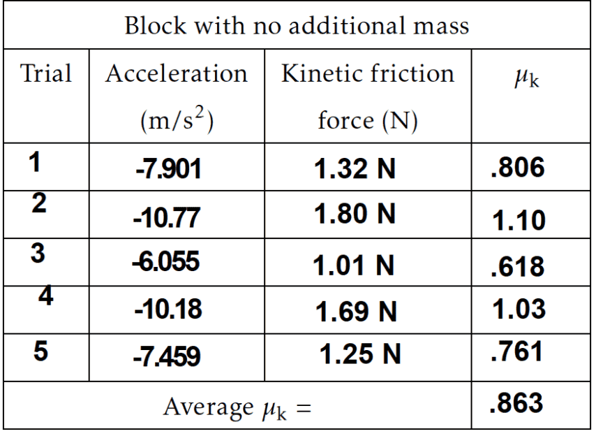

We used a motion detector to measure the velocity over a period of time. From that we were able to find the slope which was the acceleration. In this case the block was given an initial push and allowed to come to rest. The slope of the graph from push to rest was a linear slope downward which indicates the is decelerating.
So the only quantity I had was acceleration. With only that quantity I was left to find the coefficient of static friction and the Force of the kinetic friction. I used this formula
to find the coefficient. I then used that coefficient to find the kinetic friction force.Below are my results:
So the only quantity I had was acceleration. With only that quantity I was left to find the coefficient of static friction and the Force of the kinetic friction. I used this formula View attachment 279645 to find the coefficient. I then used that coefficient to find the kinetic friction force.Below are my results:
Your table gives average acceleration (and hence average ##\mu_k##) during each run.
You have quite a wide spread of values (more than ±25%). Any suggestions why there’s such a large spread?
If ##\mu_k## depends on speed, then the frictional force, and hence acceleration, would change as the object slows down. This would result in acceleration changing during a run.
Do you have enough data to produce a velocity-time graph for each run? (If ##\mu_k## didn’t depend on velocity, what would the velocity-time graph look like?)

Do you have the data on the coefficient of friction as a function of the initial velocity of the block? How can you say there is no dependence on the velocity when you haven’t compared with even one piece of velocity data?
