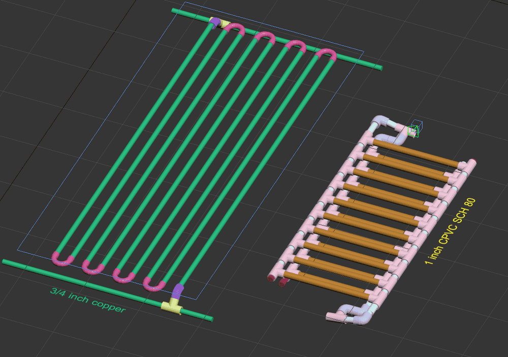

So when I evaluate different materials for thermo efficiency, does a copper pipe's surface absorb solar heat at the same rate it gives off heat?

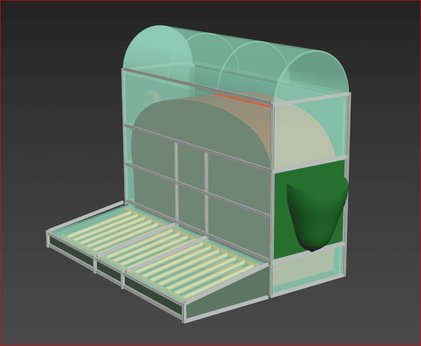

My question is specific to a solar water heated, anaerobic digester project already under construction. The digester itself is a soft tank, tightly sitting inside a frame and acrylic panels, ... heated from underneath with solar heated water.
The plan for the sake of economy, is to use 3/4" cPVC pipe in a clear sealed "cabinet", for collecting the solar rays, that connects adjacently, to another pattern of 3/4" type N copper under the tank to heat the tank.
Attached are some slightly obsolete images, I just used to grab quickly, ... but they may help to visualize
Software rendering of two pipe layouts: at left, a serpentine grid of green copper pipes labelled 3/4 inch copper with pink bends; at right, a grid of tan and pink pipes labelled 1 inch CPVC SCH 80.3D render of a solar heater cabinet with a translucent arched cover, pipe-like tray rows on the front, and a green block on the right side panel.
So if there is a large disparity between the Collector (cpvc) and the Radiators'(copper) conduction rates, ... am I wasting time using copper for the radiator, because of that disparity?
I was hoping using copper as the Radiator, would use the heat from the cPVC with the optimum efficiency.

No; the conditions of absorbing and releasing heat tend to be very different from each other, so the rate is typically different.
Maybe, but it is really difficult to determine something like that ahead of time. Ultimately the system will reach an equilibrium where the rate of absorption of heat from the sun and release of heat from the copper will equalize. So each component of the system affects the total heat transfer rate.
I assume you are using water as a heat transfer fluid? What sort of temperatures are you looking for? (both the temperature in the digester and ambient). Do you know how much heat you need?
Apologies for delaying responding!
I'm on the road and missed your message.
I will follow up with more info in another reply... But the surface of the bladder tank (in contact with the copper tube radiators) cannot exceed 60C, and the digestate within the tank cannot exceed 50C.
In the warmer seasons (mid-atlantic coast), no heating of the tank is needed. My project is exploring through solar heating, the feasibility of extending the months anaerobic digestion can be used in regions that experience a cold weather.
