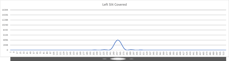

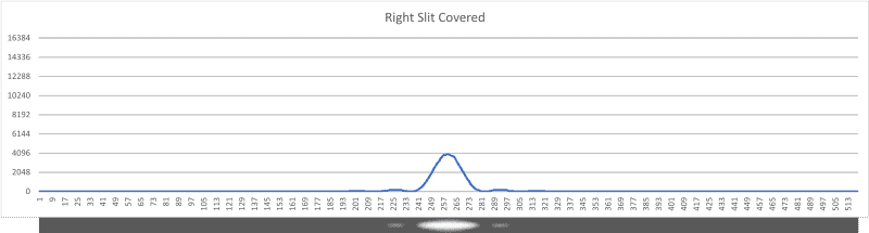

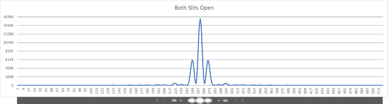

I’m talking about this region:
collinsmark said:
According to ideal theory, the average pixel value with both slits open should be quite close to twice the average value of a single slit.
OK, that is pretty solid. I guess my understanding was wrong. I didn’t expect it to be independent.
With the double slit if you think of the edges of the slits as separate light sources from the star (ie where the light reflected off the edges of the slits), with the central peak region you have 5 sources (odd number)… ie source 1) The light from the star that didn’t reflect that went classically straight through the slits to the central peak & sources 2) - 4) the light that reflected off the 2 edges of the 2 slits…
…but farther away from the central peak region the number of light sources switches from odd to even… you don’t have any light that went classically directly from the star and you only have the 4 edges as sources.
I wonder if there is less than double the number of photons detected in this region if it has something to do with having an even number of sources rather than an odd number.

Devin-M said:
I was just wondering if your measurements agreed with my original measurements that comparisons of the pattern outside the central area show far less than double the average intensity with the second slit.
I still don't understand why you expect that regions outside of the central peak to have those intensities. You have to look at the whole difraction pattern, only then you will have double the intensity for the two slits vs single slit, because you will see the whole light that goes through. But why are you expecting there to be double the intensity in same specific regions for different difraction patterns is beyond me. Which I already said in post #27.
If you have double the total mean intensity with 2 slits overall, and double the total mean intensity with 2 slits in the comparable area encompassing the 1st single slit maxima, then you should expect to find double the total mean intensity in the areas encompassing the outer maxima as well but that isn’t what my initial measurements showed.
