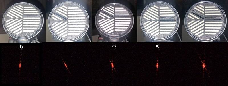

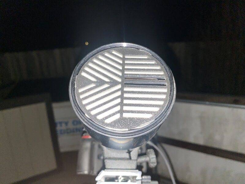

My question is when I do a double slit experiment with starlight by putting 2 slits in front of my objective lens as shown below, is the light in the areas showing destructive interference being reflected back to the star to maintain conservation of energy?
*H-Alpha narrowband filter (656nm +/- 3nm was used in front of the sensor)

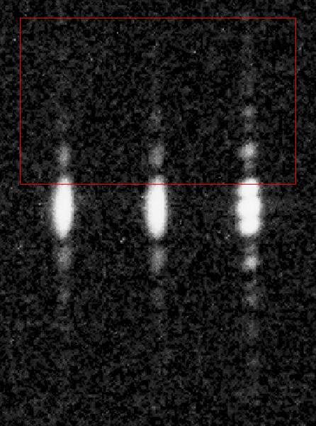

If that’s the case, if I add up the red values of a vertical strip from 1) and then 4) I would expect the total red values from 4) when added together should be approximately double the total red values from 1), since the aperture size was doubled between measurements.

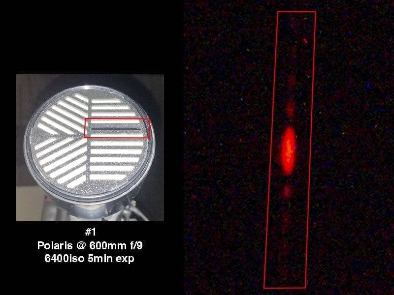

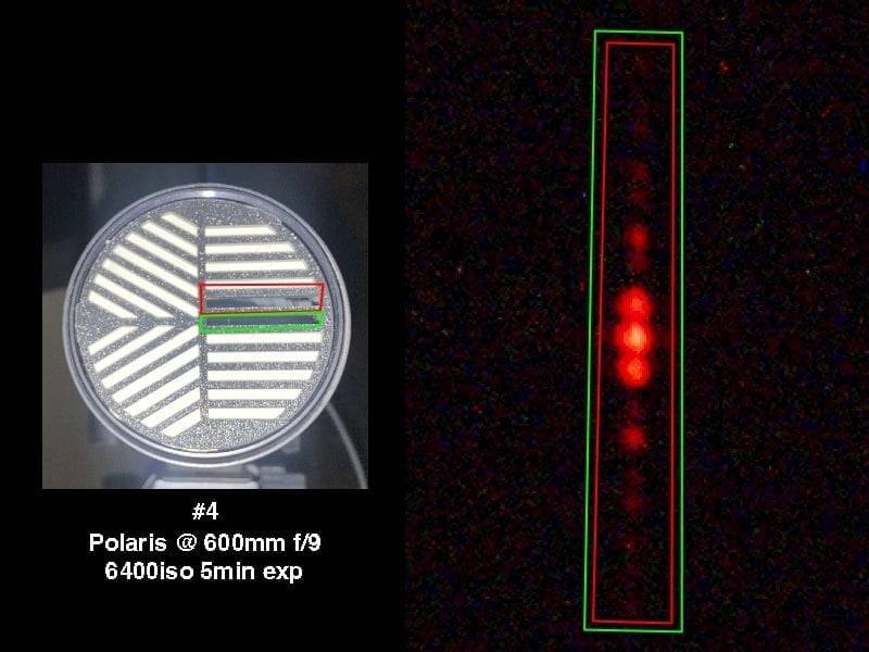

Slits were the same size, exposure length the same— each exposure was 5 minutes. We just have double the area with 2 slits. So if the photons are spatially redistributed with the double slit I expect twice the total red value with the double slit.

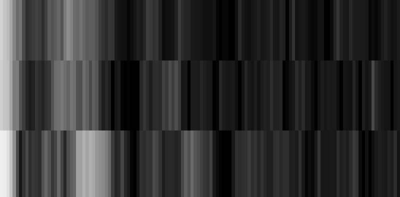

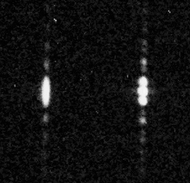

If destructive interference is preventing detection of some of the photons, on the other hand, I’d expect less than twice as much total red value with the double slit.

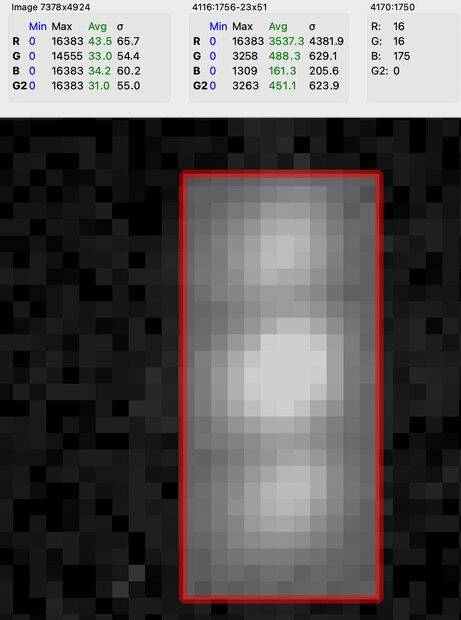

On the left is a portion of the single slit interference pattern and the right is the comparable portion of the double slit interference pattern (no pixels in these comparable portions are saturated)....
Steve4Physics said:
For the simple 2 (or more)-slit setup, energy is simply spatially redistributed. Energy is reduced in regions of destructive interference; this is exactly balanced by increases in energy in regions of constructive interference. No energy is reflected back to the source in the simple 2-slit setup.

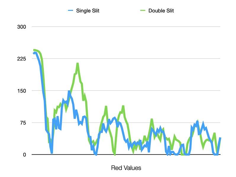

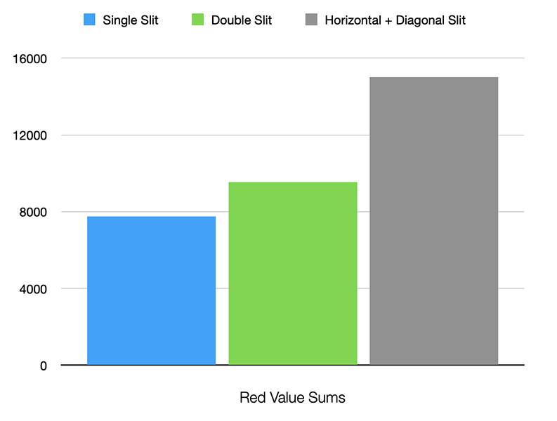

The results are:
Single Slit Red Value Sum: 7764
Double Slit Red Value Sum: 9548
There is nowhere near twice as much red value when adding the second slit. So where did the missing energy go? With the double slit, there was twice as much aperture size on the same target for the same amount of time.
Reply
  • Skeptical

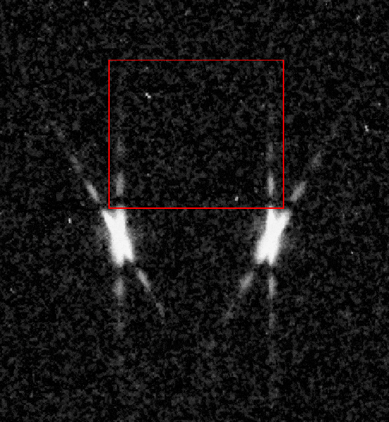

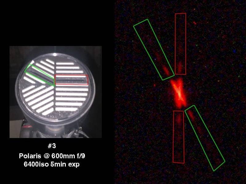

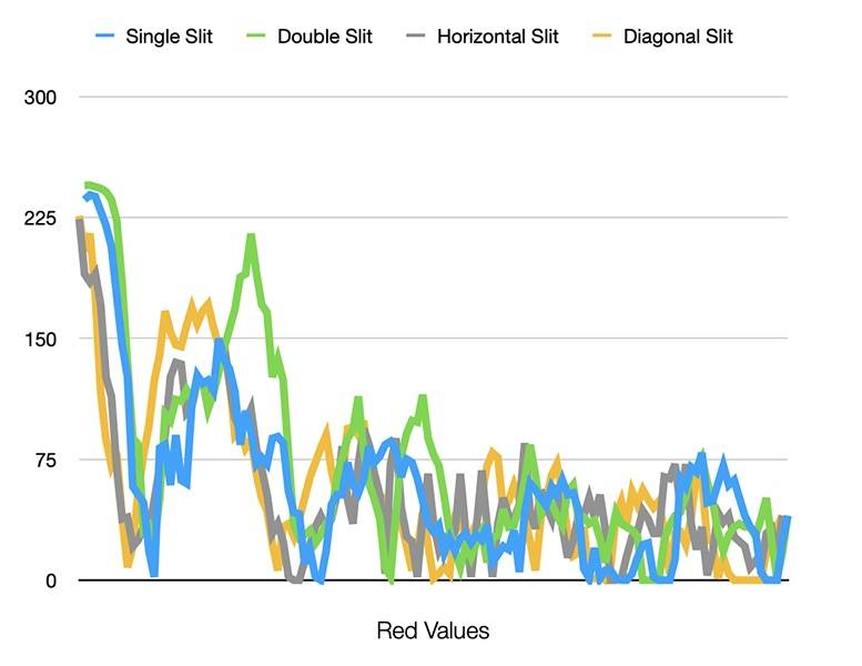

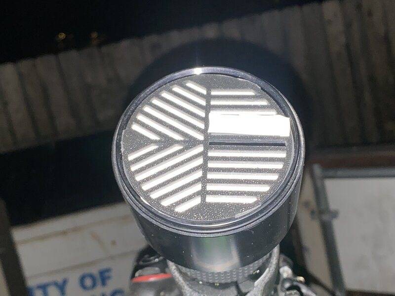

Now when I compare those results to the test I did previously with non-parallel slits (1 horizontal & 1 diagonal slit) and I add up the red values, I see almost no signs of destructive interference:
Red Values Sums:
Single Slit: 7764
Double Slit (Parallel): 9548 (1.22x higher than single slit)
Horizontal + Diagonal Slit: 15017 (1.93x higher than single slit)
In other words the horizontal and diagonal slit deposit significantly more energy in the fringes on the sensor than the parallel double slits.

Devin-M said:
Essentially the question boils down to why you get less energy in the fringes with the double parallel slit than the horizontal + diagonal slits. With horizontal & diagonal slits, I get twice as much energy as expected in the fringes (compared to single), but with the double parallel slits, about 39% of the expected energy is missing.
Different systems have different energies. The question isn't why is there missing energy. There isn't any missing energy, there is just different energies for different systems.
The question is why do you personally expect the energy of those two different systems to be the same?
It’s unexpected as it implies if I do 5 minutes through both parallel slits at the same time then compare with 5 minutes through one parallel slit only followed by 5 minutes through the other parallel slit, I’ll get ~62% more energy on the sensor in the later case.
It is not unexpected. They are different setups and the energy with different setups is not expected to be the same.
If it is unexpected to you personally then you personally need to explain your expectation in detail. There is some reasoning step that you are doing wrong in your personal expectation, but if you don't describe your personal reasoning behind your expectation then we cannot help you.

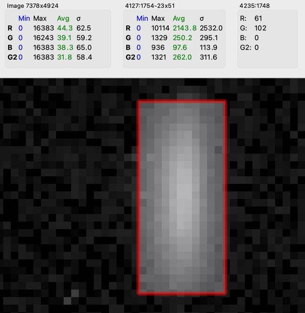

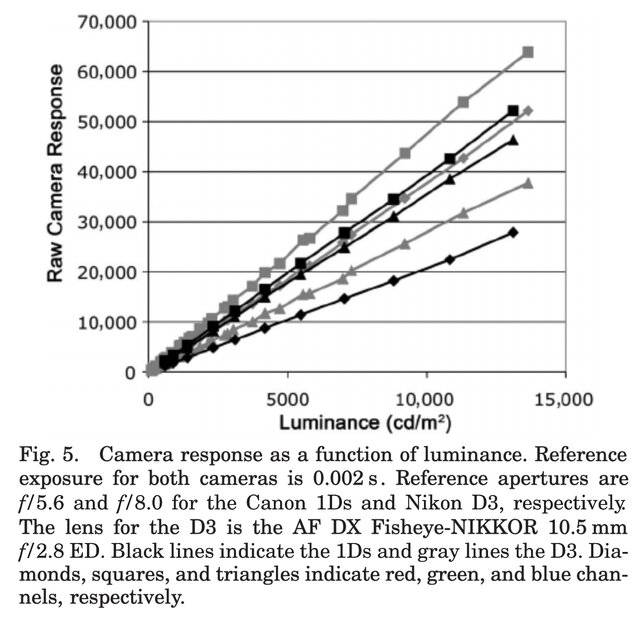

Yes, sorry. What I’ve been measuring and calling “Red Values” and “Red Value Sums,” are more technically referred to as “ADUs” or analog to digital units since I am measuring them out of the raw sensor data.
@collinsmark can explain better than me but basically, since I used a H-Alpha narrowband filter in from of the sensor (656nm +/- 3nm), so the sensor is only receiving one wavelength of incident light, the ADUs can be multiplied by a constant to get the photon count.
collinsmark said:
I'll use JWST my first example, and my own camera as a second example:
JWST:
First, you can find the specs here:
https://jwst-docs.stsci.edu/jwst-ne...detector-overview/nircam-detector-performance
Note the "Gain (e-/ADU)" and the "Quantum efficiency (QE)" in Table 1.
As you can see, JWST uses two different gain settings, one for short wavelengths and another for long.
The Quantum Efficiency (QE) is naturally dependent on the wavelength.
So let's say that were presently using JWST's F405M filter, which is a long wavelength filter with a passband at 4 microns.
Going back to Table 1, we see that
Gain: 1.82 [e-/ADU]
QE: 90% [e-/photon]We can convert that to photons by dividing the two:
1.82 [e−/ADU]0.9 [e−/photon]=2.02 photons/ADU
So for when JWST is using its F405M filter, it takes on average about 2 photons to trigger an ADU increment.

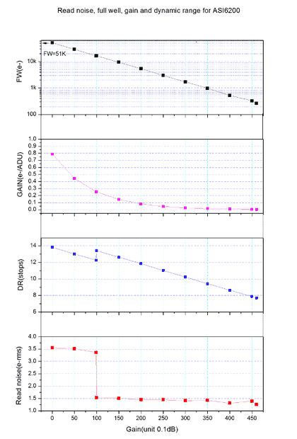

My Deep Sky Camera: ZWO ASI6200MM-Pro:
You can find the specs here:
https://astronomy-imaging-camera.com/product/asi6200mm-pro-mono
So, for example, if I'm using my Hydrogen-alpha (Hα) filter, which as a wavelength of 656.3 nm, we can see that the QE is about 60%.
But if I set my camera gain to 0, corresponding to around 0.8 [e-/ADU], that gives
0.8 [e−/ADU]0.6 [e−/photon]=1.33 photons/ADU
So with this gain setting and when using the Hα filter, it takes on average about 1.33 photons to increment an ADU.
(I like to set my camera gain to something higher for better read noise, but I'll just use a gain setting of 0 here for the example.)
Had I instead set the gain setting to around 25, which corresponds to somewhere close to 0.6 [e-/ADU], that would correspond to roughly 1 photon/ADU on average.

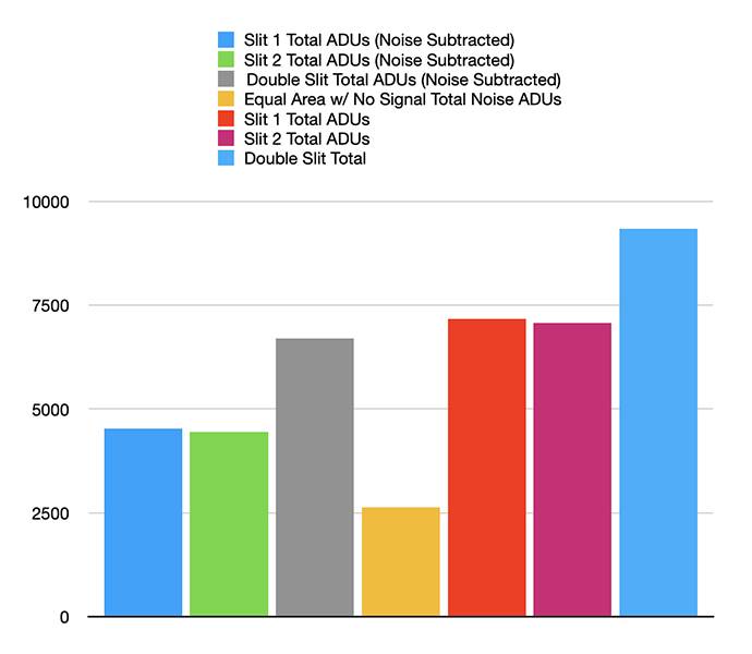

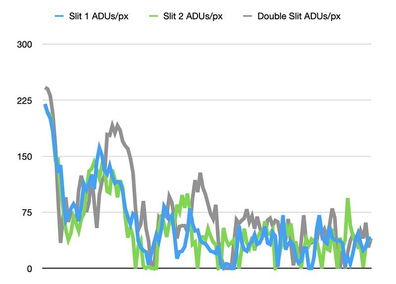

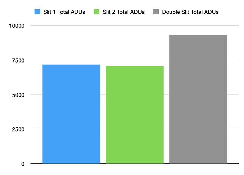

I performed a new test, this time where I measured each slit individually, and then both at the same time:
Slit 1 ADUs: 7165
Slit 2 ADUs: 7076
Double Slit ADUs: 9339
Each test was targeting the star Polaris with a 5 minute exposure, 600mm, f/9, 6400iso, with a H-Alpha narrowband filter (656nm) in front of the sensor on a Nikon D800 DSLR, and the camera was mounted on an equatorial mount to compensate for the Earth's rotation.

And how did you perform the background correction? Did you take a picture with all slits closed as the background and then subtracted this data from your other pictures pixel by pixel or did you subtract some flat background?

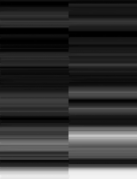

The pictures are so grainy I have a hard time believing you can conclude anything meaningful from them.
We all know that the pattern for the single-slit and the double-slit at the same place cannot be the same, so I would expect a different light intensity there, but not necessarily double the intensity of a single-slit.
Also, why don't you take the start of the measurement from the center (as it seems to me the double-slit measurements have the center much brighter than the single-slit measurements), as that can account for the missing light.
Devin-M said:
Slit 1 ADUs: 7165
Slit 2 ADUs: 7076

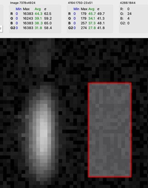

I've now (at your suggestion) looked at how much noise is in equal area with no signal...
Noise ADUs in area w/ no signal: 2634
Slit 1 ADUs w/ noise subtracted: 4531
Slit 2 ADUs w/ noise subtracted: 4442
Double Slit ADUs w/ noise subtracted: 6705 (1.47x higher than slit 1)
Noise Sample:
