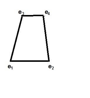

@PeterDonis, there is definitely a missing piece to the Schild argument for curved spacetime, and I don't know how to repair it. The idea is to create a "parallelogram" in spacetime. At point [itex]e_1[/itex], a light pulse is sent from the lower observer to the upper observer. [itex]e_3[/itex] is the event where the light pulse reaches the upper observer. Then a second light pulse is sent at point [itex]e_2[/itex], which reaches the upper observer at event [itex]e_4[/itex]. Schild's argument is that since the "length" of the segment [itex]s_{12}[/itex] is smaller than the length of [itex]s_{34}[/itex], spacetime must be curved.
But the issue is: how do we know that quadrilateral [itex]Q_{1243}[/itex] is a parallelogram? In the case of Rindler spacetime, it clearly is not--it's a trapezoid. So what's the argument that it should be a parallelogram in the Schwarzschild spacetime case?
(Whether a figure is a parallelogram or a trapezoid is coordinate-independent. So we know that the figure is a trapezoid in Rindler spacetime because that's what it is in Minkowsky spacetime.)
PeterDonis said:
Consider two observers at rest in the gravitational field of the Earth, one at height ##z_1## and the other at height ##z_2 > z_1##. The lower observer sends two successive light pulses to the upper observer. This defines four events in spacetime as follows: E1 and E2 are the emissions of the two light pulses by the lower observer, and R1 and R2 are the receptions of the two light pulses by the upper observer. These four events form a parallelogram in spacetime--it must be a parallelogram because opposite sides are parallel. The lower and upper sides, E1-E2 and R1-R2, are parallel because the two observers are at constant heights; and the light pulse sides, E1-R1 and E2-R2, are parallel because the spacetime is static, so both light pulses follow exactly identical paths--the second is just the first translated in time, and time translation leaves the geometry of the path invariant.
However, the lower and upper sides of this parallelogram have unequal lengths! This is because of gravitational time dilation: the upper side, R1-R2, is longer than the lower side, E1-E2. This is impossible in a flat spacetime; therefore any spacetime in which gravitational time dilation is present in this way must be curved.
The problem is that the above argument would seem to apply equally well to a pair of Rindler observers in Minkowski spacetime! The worldlines of observers at rest in Rindler coordinates are orbits of a timelike Killing vector field, so two successive light pulses from a Rindler observer at ##z_1## in Rindler coordinates to a second observer at ##z_2 > z_1## should be parallel, and so should the worldlines of the observers themselves. So we should have a parallelogram in the same sense, but with two opposite sides unequal--which should imply that Minkowski spacetime must be curved!
So the question is: how do we reconcile these apparently contradictory statements?
We reconcile them by noticing that one of your statements is erroneous, namely:
This is impossible in a flat spacetime.
It's impossible to have a parallelogram in flat space for which all four edges are geodesics and two opposite sides have unequal lengths. However, the 'parallelograms' you are talking about - in both the Schwarzschild and Rindler geometries - do not have all four edges being geodesics: two of the edges are paths traced out by accelerated observers. Such a 'parallelogram' can have opposite edges with unequal lengths in either flat or curved spacetime. Indeed, you have just observed this.
So, there's no contradiction.

how do we know that quadrilateral ##Q_{1243}## is a parallelogram? In the case of Rindler spacetime, it clearly is not--it's a trapezoid. So what's the argument that it should be a parallelogram in the Schwarzschild spacetime case?
I'm not sure, because I'm not sure how to rigorously define "parallel" in a curved spacetime. In fact I'm not even sure that the definition in flat spacetime, under which the figure ##Q_{1243}## is a trapezoid, is unique. Schild's argument, at least as it's presented in MTW, appears to be using the timelike KVF of the spacetime to define "parallel", but in flat Minkowski spacetime there are two sets of timelike KVFs (roughly the inertial and Rindler ones) which give different answers (and the Schwarzschild KVF corresponds to the Rindler one, since observers following its orbits have nonzero proper acceleration).
@DrGreg brought up this objection early in the thread, and my suggestion to address it was to switch to a slightly different scenario where all four sides are geodesics. I described this variant in post #3; as far as I can see, the two timelike geodesic sides are still of unequal length. The question would be, do they still count as "parallel"? As I noted in response to @stevendaryl above, I don't know what definition of "parallel" is the right one to use in this context. I'm not even clear about this for the non-geodesic sides that appear in Schild's argument.
Does this mean that Schild's argument is invalid?
It's hopeless to define "parallel" in a curved spacetime, but it makes perfect sense in the Rindler spacetime, and with that definition the opposite sides of a parallelogram in that spacetime have equal length.
I could try to explain all this, but that's unnecessary if all we want is to find the mistake in your "paradox". You claimed:
However, the lower and upper sides of this parallelogram have unequal lengths! This is because of gravitational time dilation: the upper side, R1-R2, is longer than the lower side, E1-E2. This is impossible in a flat spacetime.
Whatever definition of "parallelogram" you take, if it includes the figure in Rindler spacetime that you discussed later in your post, then it is possible to get such a thing with opposite sides having unequal lengths.
So, there's no paradox. I think we need to agree on that before we going into deeper waters, like "what's a parallelogram in the Rindler spacetime?"

So how would you define it in Rindler spacetime? Specifically, consider the quadrilateral formed by the following points in Rindler coordinates:
##(-t, x_1)##
##(-t, x_2)##
##(t, x_2)##
##(t, x_1)##
where ##x_1 < x_2##. Is this quadrilateral a parallelogram?

if you want a parallelogram with unequal opposite sides, take two concentric circles and two radial sides
I agree that this figure has two unequal opposite sides; the question is whether it is valid to call it a "parallelogram". And yes, similar remarks would apply to the corresponding figure in Schild's argument.

By definition, that would not be a parallelogram. Am I missing something?
In Euclidean geometry, a parallelogram is a simple (non-self-intersecting) quadrilateral with two pairs of parallel sides. The opposite or facing sides of a parallelogram are of equal length and the opposite angles of a parallelogram are of equal measure.
Well, that's the question. Note that your definition says "in Euclidean geometry"--but we are dealing with arguments which assume the possibility of non-Euclidean geometry.
Ah. THAT's what I missed. Thanks Peter.
My impression following this discussion is that it might be difficult but not per se impossible to define a parallelogram in curved spacetime.
In Euclidean geometry all edges are in a plane. Taking this as a criterion wouldn't it require to define a parallelogram in curved spacetime in a plane of simultaneity? In which case the geodesics would be spacelike however.
