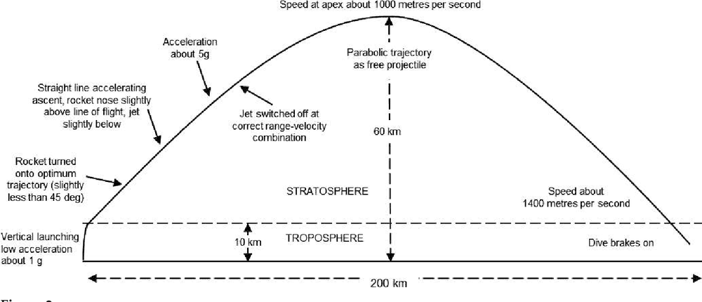

I am trying to understand several things. Germany started working on the V2 rocket about 1930 but did not launch until until about 1943 & 1944. The rocket had 25 tons of thrust on 75% ethanol 25% water plus liquid oxygen. The engine ran full throttle for 70 seconds that put the rocket 50 miles above earth. The rocket coasted up to a total of 120 miles with no engine thrust before it returned to Earth in 210 seconds.
NASA space program was based on German rocket technology the engine had a fuel pump that makes the engines run at full throttle until fuel is gone.
Space X rockets have no fuel pump. They use 300 psi helium to pressurize the liquid methane & liquid oxygen. SpaceX engines run about 1/4 throttle compared to German technology.
I am trying to understand when fuel runs out how far can a rocket coast with no engine thrust before it reaches maximum distance from earth.
I was thinking if I knew and understood gravity, and know a rocket weights 12 tons, travels at 3400 mph for 70 seconds. I could get a better understanding about how far a rocket could be predicted to travel when fuel runs out.
I have an idea that a rocket engine can gradually throttle down at the same rate that gravity degreases and maintain the same speed because at a certain elevation there is no atmosphere and no wind resistance.
In 1930 it is interesting Germany knew with no knowledge of rockets that a rocket would coast 70 more miles up after engine was off. The law of motion probably let then calculate distance assuming they knew the value of gravity at 120 miles up.
