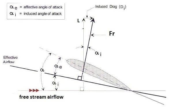

This is usual induced drag diagram.
I have 2 questions:
From Kutta–Joukowski theorem Fr is always perpendicular to effective airflow.
1. Does it mean for case without effective airflow(zero induced downward velocity), Fr is perpendicular to freestream airflow,so drag is zero?
When effective airflow reduce AoA, Fr magnitude must also be reduced(example:Fr at wing is smaller at 6° then on 10°), that mean lift also decrease. What then keep lift constant to satisfy L=Weight?
So we must pull yoke and inecrease AoA to keep lift the same, that will increase downwash so Fr will tilt even more back, and induced drag will rise even more.
2.Does this theory usualy inculde L=Weight condition or not, so is induced drag shown at pictures is for L=weight condition or without?

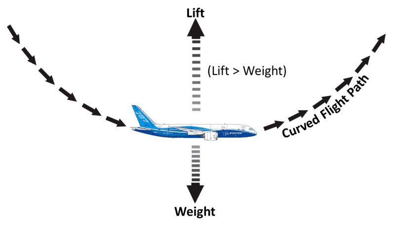

I just want to leave this concept for you to consider:
The wing can be loaded or not.
If you do a FBD and all forces are in balance, the wing will fly straight.
If lift is greater than whatever opposite force, the wing will move up respect to airstream.
If less, the wing will move down.

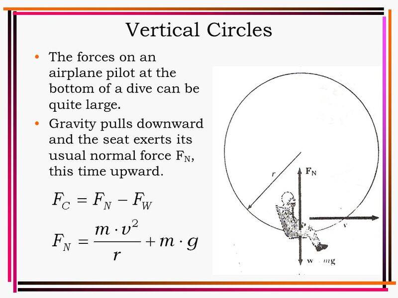

While performing a vertical round loop, the amount of needed lift will be maximum at the bottom, almost zero at 3 and 9 o’clock, and negative at top.
As an aerobatic loop should be performed at constant velocity, the pilot only has the elevator to change it via changing the AoA.
Slide titled Vertical Circles showing a pilot seated at the bottom of a circular loop of radius r, with upward normal force FN and downward weight mg, plus formulas FC = FN - FW and FN = m v^2 / r + m g.
Free-body style diagram of a Boeing airliner in a curved flight path, with Lift arrow pointing up, Weight arrow pointing down, and label (Lift > Weight).

My question 2. only ask is general induced theory keep L constant when drawn forces from AoA freestream(no downwash) to AoA effective(downwash)?
Because if you keep L constant,and after you include downwash(eff.AoA) then you must increase additionally AoA to compensate reduction in lift due to tilt back of resultant force,so you end up with even more induced drag compare if you didnt keep L constant.

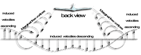

Lift, and its associate lift-induced-drag, are a direct result of the AoA that certain section of the wing is “feeling”.
In this case, the diagram seems to show how the “felt” AoA varies for different sections of the wing.
Less AoA always results in less lift, as all the sections of one wing are moving at the same forward velocity.
As you can see in your diagram, the length of vectors L and Fr are different, as it should be.
A rectangular wing always creates more pressure differential (more lift) toward the root and middle section, while there is more pressure by-passing from bottom to top (less lift) toward the wingtip.
The peculiar upwash-downwash of the tip vortex reduces the AoA toward the wingtip, and changes the direction of the vector lift (increases drag), but also reduces its value (reduces drag).
Please, see:
https://link.springer.com/article/10.1007/s11012-020-01230-1
Back view diagram of a wing with marginal free vortices shedding from each tip, with induced velocities ascending outboard of the tips and descending across the span between them.
I have 2 questions:
That's not from Kutta-Joukowski, that's just from how lift is defined. It also happens to be the angle of the resultant force if you assume the flow is inviscid. In any real flow, this won't be the actual force direction, since there will be a nonzero viscous drag component, but it's handy to split the force up into a component perpendicular to the incident flow (lift) and a component parallel to the incident flow (drag).
Well, in a case where you ignore viscous drag and also have zero induced velocity, yes, the drag is zero. In reality there is also always some viscous drag.
I think that you're imagining this a bit backwards here. The lift doesn't decrease because the wing never saw that "real" 10 degree angle of attack in the first place. As you pitch the wing up, the induced flow is also created, so as you pitch the wing from 0-10 degrees geometrically, the angle of the incident air smoothly goes from 0-6 degress (in your example), so there's a smooth increase in lift as you pitch up (it's just a shallower lift slope than you expect if you neglect to account for this factor).
You still end up with lift equal to weight, it just happens at a slightly higher angle of attack than you'd expect looking at the section polar alone.
Yes, but your lift still increases, so there's still an angle where everything balances out. In addition, for most real planes, this effect is quite small - induced drag is really pretty minimal unless you have an airplane with a very short aspect ratio.
Jurgen M said:
2.Does this theory usualy inculde L=Weight condition or not, so is induced drag shown at pictures is for L=weight condition or without?View attachment 317316
L=weight is only true in level, unaccelerated flight. This certainly applies in that situation, but it also applies in other situations, like turning flight (where a higher Cl is needed), or in a pushover (where lower Cl is needed). There's nothing inherent about this that necessitates that you're at a single flight condition, and as I said, if you actually plot out the lift and induced drag vs a range of geometric angles of attack, you'll find that you still have a smooth lift polar, it just has a slightly lower slope than it would if you had the behavior of a 2d section.
