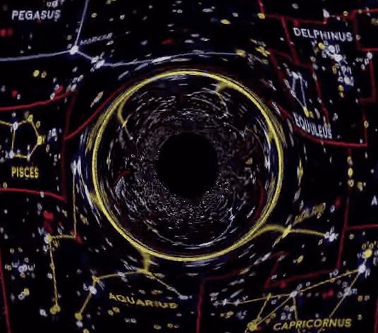

Orodruin said:
On this topic, here is an animation I created some years back. It shows how an idealised Schwarzschild black hole would bend the (far) background - here represented by a star map based on Earth's location. The animation shows how the view would look for a stationary observer and the elapse of the video represents different positions of that observer.
Consider this frame for example:
The black circle in the middle represents the optical size of the black hole, i.e., if you send a light signal in that direction, it will end up inside the black hole. By time reversal, no light can come from that direction (unless emitted by something in between the black hole and the observer). The yellow circle is an Einstein ring - it is light from an object that is directly behind the black hole (in this case Sadalmelik, aka ##\alpha##-Aquarii).
