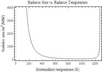

Just to put some numbers on this. Suppose that the heat source is pretty hot, producing heat at 1000ºC (1273 K). And suppose further that the device is in thermal contact with deep space, as I suggested, and so it is using deep space as the cold reservoir (2.7 K). So the Carnot efficiency is 1-Tc/Th = .998. This means that for every 1 MW of heat produced, the device could capture 998 kW as work (or other low entropy forms of energy) and would have to dump 2 kW to deep space to satisfy the second law of thermo.
You can use the law for radiative power transfer for a black body, which is \dot{Q}= \sigma (T_h^4-T_c^4) A. So to radiate 2 kW at 1273 K to a bath of 2.7 K requires an area of .014 m².
You can just scale those numbers up by however many MW you expect your power plant to produce.
The technological advances would be to use deep space as the cold reservoir while radiating at the hot temperature. That isn't something we could do now, we would use a radiator as the cold reservoir which would be at an intermediate temperature between 1273 K and 2.7 K, reducing the maximum efficiency of the engine and increasing the surface area required to radiate. But that would be the limit of what is possible according to the laws of physics as we know them, so that would be the limit of what you could get away with using "future tech" but not breaking the laws of physics.
