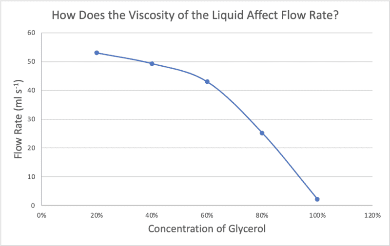

I investigated the flow rate of differing dilutions of glycerol through an orifice of a vertical tube and obtained the following:

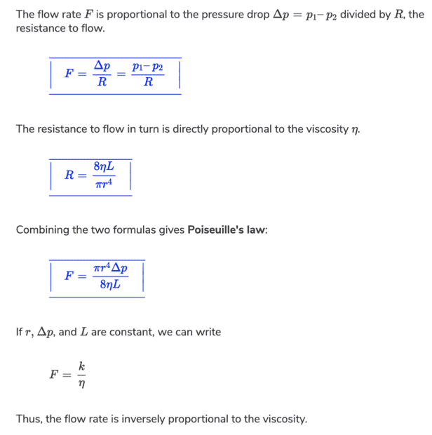

I'm looking for a way to quantify these results so looked to Poiseuille's Law;
I'm pretty sure my graph does not show inverse proportion? Could anyone advise me as to where I've gone wrong / if there is another law governing this relationship - does Poiseuille's Law apply for the vertical motion of fluids?
