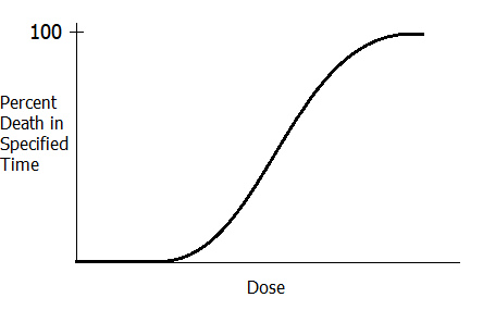

For many poisons, there is a "safe dose". As an extreme example, there is such a thing as "water intoxication". Drink enough water and and your cells will swell up - perhaps lethally. But drinking normally is not just harmless, it's essential.
A strong argument can be made that, except for acute radiation poisoning, ionizing radiation does not follow that pattern. As best anyone knows, a single unlucky photon is able to directly or indirectly break a DNA molecule in a way that, in time, allows its cell to be the start of a cancerous growth.
So what can accumulate is risk. If you are lucky, an exposure to ionizing radiation (either naturally or from an medical procedure) will not create anything that can promote cancer. But you don't want to take that risk more often than you need to. Eventually, the odds could catch up to you.
But let me attempt to answer your question a bit more directly. Most DNA damage is not cancerous - it may have a benign effect on the cell or just out-rightly kill it. If it does make the cell cancerous, your immune system might recognize it and destroy that cell. In the most unlucky case, the damage reprograms the cell to grow unchecked but to do it in a way that doesn't trip your immune system.
Now that you have a notion of the process, you may ask what is the timeline for this process. The best answer I can find is from an article from the "Health Physics Society" website "Radiation Answers" which starts by saying:
This discussion isn’t as easy as being able to say “here’s a dose and here’s the effect of that dose.” Our current medical knowledge does not allow us to identify what causes a cancer, so a radiation-induced cancer doesn’t look any different than the same cancer caused by other possible agents. We do know that radiation-induced cancers do not appear until at least 10 years after exposure (for tumors) or 2 years after exposure (for leukemia). This time after exposure to possible cancer formation is called the “latent period.” The risk of cancer after exposure can extend beyond this latent period for the rest of your life for tumors or about 30 years for leukemia.

The units and conversations in this field is a maze. In the Radiation Biology class/lab I took at San Diego State white mice were irradiated with a Westinghouse x-ray. I forget all the data, ie how many Rads (100 ergs/g) they got. We moniteted the decreasing blood cell counts for as long as they lasted, a few weeks. So it would seem a proportional dose in humans would also be fatel.
morrobay said:
So it would seem a proportional does in humans would also be fatel.
The mouse LD50 the dose needed to kill 50% of a population of mice is about 7 Gy (700 rads). The LD50 for humans is only around 4 Gy (400 rads).
