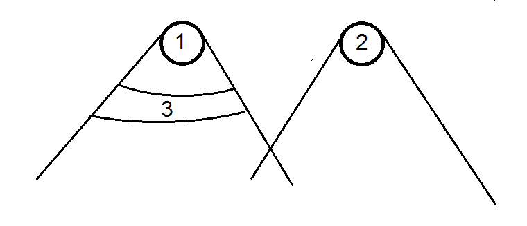

As In following diagram (credit stevendaryl) where Alice and Bob are spacelike separated.
