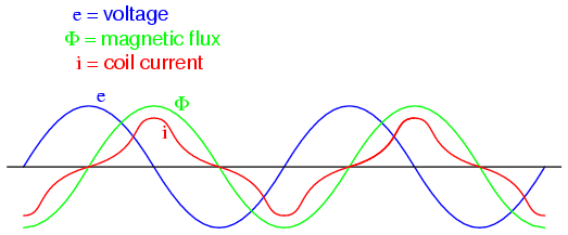

Odd harmonics in a sine-like wave arise from symmetric distortion about zero - for example flat tops and bottoms or peaky tops and bottoms...mirror image distortion.
Even harmonics are not mirror image, they'd give perhaps a flatter top peak and more sharply pointed bottom peak.
Transformer core is operated not far from knee of B-H curve.
http://ttradio.net/images/magcurrent.jpg
image from: http://ttradio.net/basic-concept-of-tube-amp-output-transformers/
So magnetizing current will have a peak around time of the voltage zero crossing , to push flux on around the curvature of approach to magnetization curve's knee.
It'll be mirror image distortion.
Here it is in color...
image courtesy http://www.ibiblio.org/kuphaldt/electricCircuits/AC/AC_9.html
Think about the physical force between laminations - will it not be greatest at flux peaks, when current peaks to push flux through that higher reluctance ?
So, with the driving function for mechanical movement, flux, being in proportion to absolute value of a sinewave having lots of third harmonic, I'm not surprised it has so much 6th (twice third).Great image , zoki !

Flux is proportional to mmf but not linearly because we're approaching the knee and that's why current departs from cosine, sprouting those lumpy peaks.
When voltage is a sine sans harmonics , flux will be a cosine sans harmonics .

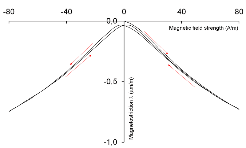

Magnetorestrictive force that causes the hum is attributed by hyperphysics to the magnetic field which i take to mean flux , so i may be all wet on that current-flux connection as the source of third harmonic.
http://hyperphysics.phy-astr.gsu.edu/hbase/Solids/magstrict.html
You may have noticed the humming sound associated with a transformer or a fluorescent light ballast. For U.S. circuits, that hum will be at 120 Hz since the iron material associated with the transformer core responds mechanically to the magnetic field which is impressed upon it. The effect is called magnetostriction, and it is one of the magnetic properties which accompanies ferromagnetism. For 60 Hz applied magnetic fields in AC electrical devices such as transformers, the maximum length change happens twice per cycle, producing the familiar and sometimes annoying 120 Hz hum.
MMF is proportional to current,
and current has odd harmonics. as shown in two pictures in post 12.
but flux won't unless the applied voltage contains some. d/dt of sine and cosine have same shape.
here's a Wiki showing restriction is unidirectional which is why, as others pointed out , frequency gets doubled.
Observe they plot it vs mmf not flux - . grrrrrr:mad: .
http://upload.wikimedia.org/wikiped...trictive_hysteresis_loop_of_Mn-Zn_ferrite.pngThere is mention that magnetorestriction is not linear with flux, and that would be a source for audible harmonics as demonstrated by zoki's analyzer..
http://adsabs.harvard.edu/abs/1926PhRv...28..146M said:
The magnetostriction-magnetization curve has initial slope zero in all the cases studied. When the attainable field was sufficient for magnetic saturation the magnetostriction reached a limiting value.
and figure 3 here shows restriction vs flux density
http://encyclopedia2.thefreedictionary.com/magnetostriction
that's pretty nonlinear.
