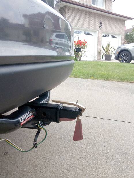

Should I have ground the rust off this steel project before applying primer? Should I go back and do it?
I'm making a thing - a trailer hitch accessory - out of steel leavings (from a steel shop). (This is not a functional gadget; it is purely aesthetic. It is removed when the hitch is in use.)
The steel wasn't rusty when I brought it home, but it's acquired a few light patches of rust as I've worked on them over a couple of weeks. The worst spot is where two pieces rested on each other, and I guess moisture accumulated and made a patch of rust a half inch square.
I had intended to do a light grinding to remove oxidation and expose fresh surface before painting, but I got the two steps mixed up and foolishly decided to give it a light coat of primer in prep to grinding/rasping/sanding off any last imperfections. Now I can't tell where the rust spots might be.
I'm using standard Tremclad rust paint.
Now that it's kind of too late, have I doomed my project to rusting out? Should I take the time to grind/sand off the primer? Or am I OK?
(Wait, am I using the wrong term? This isn't rust rot; this is light surface oxidation.)
Remove loose surface rust with a wire brush or grinder.
Treat the surface with rust converter = phosphoric acid.
When it is dry, the rust will be converted to black.
Prime the surface with Tremclad rust paint.
If you did not prepare and rust convert the surface, don't go back.
Rely on the hope that Tremclad will cover and seal any surface rust.
If you can see rust flakes through the primer, you will need to go back to chip the flakes, and prepare the surface again.

Thanks OK. It sounds like I don't have to start again.
I just ground off the spot where it was the worst. And even that was just surface oxidation.
Pics to follow.

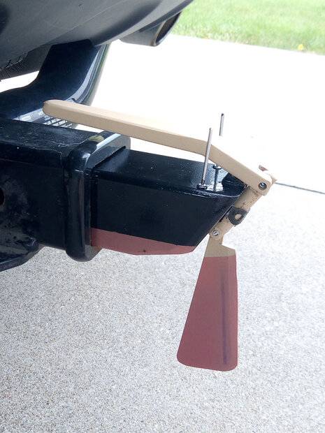

The only reason it was a timely issue was that I would have wanted to do the grinding/sanding before assembling it. Because it's riveted it can't be taken apart once assembled.
But it's all fine.
A kick-up rudder - nice. It seems a bit small for the size of the 'boat'...
Reply
  • Haha
I seriously ruminated over how hazardous it might be to have a steel blade hanging down from the stern of my car. There's a mall entrance nearby where cars regularly bottom-out on their tow hitches...
