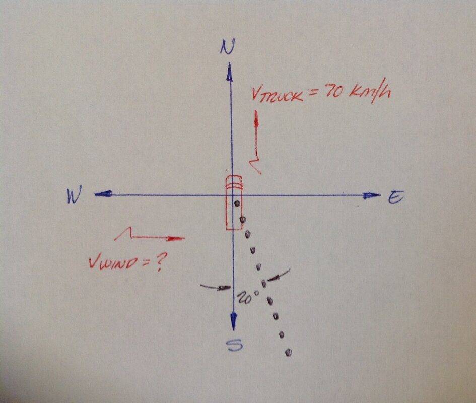

For the purpose of this problem, you can consider any exhausted mass of combustion gas to remain at the spatial point at which it was exhausted, then, the wind starts pushing it Eastwards from that point.
If you could draw a horizontal line between that mass and the next one that came out from the moving North exhaust pipe, your line would form a 20° angle respect to the North-South line.

Only to simplify things, we are assuming that the velocity of the exhausted gases respect to the truck is 70 km/h Southward.
Even if that velocity of the exhaust were higher or lower, each puff of smoke would eventually slowdown and come to a still condition in the absence of that crosswind, again forming a line conditioned for the uniform time delays among consecutive spuffs of smoke.
Relative to a ground observer, the truck is moving North at 70 km/h and the velocity of its exhaust is initially zero; then he sees that puff of black smoke start being carried away Eastward by the wind.
Next puff will be exhausted a little further North and with some time delay, then behaving as previous one.
Just as a line is a set of points, the exhaust trail of our problem is a set of puffs of smoke.
The problem statement of "20 degrees east of south behind the truck" means that a line is foming an angle of 20° respect to the North-South line.
Please, see:
https://www.physicsclassroom.com/class/vectors/Lesson-1/Vectors-and-Direction

An excellent diagram given by Lnewqban at https://www.physicsforums.com/threa...he-velocity-of-the-truck.1001112/post-6471415 shows how the trail of exhaust smoke is formed and how it moves. Each puff of exhaust is moving east at wind speed relative to tip of exhaust pipe and also at the same time moving south at 70 km/h relative to the tip of exhaust pipe. Then the explanation given in above paragraph can be used since we are sure now that we are measuring velocity relative to tip of exhaust pipe i.e. the truck.

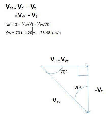

After using the great and very helpful posts in this thread, the following is the solution to this problem. We are looking at the velocity of a puff of exhaust relative to truck.
Thanks to all who helped me understand this problem.
I would label this as a difficult level problem since student has to analyze the problem and make the correct conclusions on how a puff of exhaust moves.
The answer is mentioned as 25 km/h for this problem.
SOLUTION
