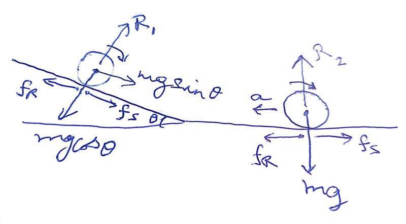

The answer in that old post didn't seem clear to me probably because it was highly summarized. There was no mention of static friction which acts in the direction of motion for a rolling object with no slippage and also of rolling friction that acts opposite to the direction of motion of center of the rolling object.
Based on my analysis, I came up the with following free body diagram of the truck wheels while on incline and also on horizontal ground. I'm not sure if the frictional forces shown are correct for this scenario. ##f_r## denotes the rolling friction force from inclined ground on the truck wheels and ##f_s## the static frictional force from horizontal ground on the truck wheels.
For truck wheels rolling on incline:
##mg sin {\theta} + f_s = f_r## and ##R_1 = mg cos {\theta}##
For truck wheels rolling on horizontal ground:
##f_s - f_r = -ma## and ## R_2 = mg ##
We know ##\theta = 7.8^o## and when the truck is moving on horizontal ground then its experiencing a deceleration ##a## that is pointing towards left. ##a## denotes the magnitude of deceleration.
I have probably committed a mistake in my analysis since I have assumed rolling friction forces to be equal on inclined and horizontal surfaces, and also I have assumed that static friction forces to be equal on both surfaces, which I think is not necessarily true. In that case, it appears that this problem is not solvable with the given information.

vcsharp2003 said:
Homework Statement:: A truck rolls down a 7.8 degree hill with a constant speed of 30.0 m/s. At the bottom of the hill it continues on a horizontal surface. How far will the truck go before it stops?
Relevant Equations:: F = ma
I guess, even equations of rotational motion about the point of contact of truck wheels with ground will need to be considered to solve this problem. Then, it will be solvable.
Not necessarily. The motion of a free-rolling truck downhill is opposed by rolling resistance, drag and axle friction, while gravity tends to accelerate it.
Since the wheels are rotating at a constant rate, there is no net torque on them. What directions of torque arise from these various forces?

haruspex said:
Not necessarily.
You mean static friction force could be in a direction opposite to direction of velocity of center? If yes, then what is the reasoning behind this.
For a car on a road the static friction acts in the direction of car's velocity, and the reason is that friction supplies the forward force to accelerate the car.
The answer is partly in what you wrote: to accelerate the car. What if the car is at constant velocity, or constant speed on a bend, or slowing down?
Also need to consider gradient. Consider a car going downhill, gaining speed, but more slowly than if freewheeling.
So, the static friction force must be in a direction to support it's resultant motion.
The direction of static friction then is not fixed for rolling object, which is what I was thinking up until now.
If the car is at a constant speed on a straight road then static friction force must be 0 as per Newton's second law of motion.
If the car is turning along a circular arched road at a constant speed, then the static friction force must be acting towards the center of circular arc so it can supply the necessary centripetal force.
It makes sense and thankyou for opening my eyes to this fact.

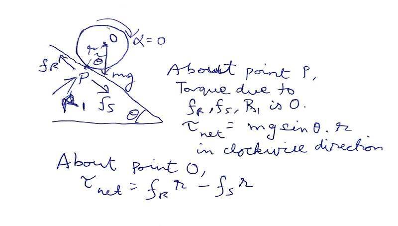

I get the following net torque about points P and O. When taking torque about point P, the net torque cannot be zero, but about point O it seems possible. I don't know why this is happening? Do I need to change my free body diagram for object rolling on the inclined surface?
Probably show ##f_s## as acting up the incline at point P. If yes, then why would this be? Is it because rolling friction is always very small and therefore, cannot balance the larger ## mg \sin {\theta}## force?
Probably, ## f_s>>>f_r##.
I assume what you are calling rolling friction is what I prefer to call rolling resistance.
It is a torque rather than a force. It arises from a shift in the application profile of the normal force. See section 4.1 of https://www.physicsforums.com/insights/frequently-made-errors-mechanics-friction/.
If the car is braking or has axle friction, that's another torque opposing motion.
Any aerodynamic drag on the car will lead to a horizontal component to the load it places on the axles.
Why is torque about point P never becoming zero in above diagram? If we consider the whole truck as single system with rolling wheels, then the axle friction would be an internal force to the system. Then, the net torque about P is never going to be zero on an incline, whereas net torque about any point must be zero if truck is moving at constant velocity.
Because you are only looking at one wheel axle. Whichever you look at, front or back, the mass centre of the car and the normal force from the ground at the other axle have torques about the point of contact of wheel on ground. The distribution of load between the normal forces can produce different torques for the same total force.
You're right. Thanks once again for such a precise explanation.
After all these posts, my view is that if I'm looking at a rolling object on an incline as the model to solve this problem, then I must not consider the whole truck/car + 4 wheels system, since its a complex model with a 3 dimensional array of forces to be looked at and not really a rolling object; rather, I must look at a single wheel as the system to model in this problem and then apply the laws of rotation to this system. The wheel mimics a rolling object perfectly and therefore, we can easily apply rotational logic to it. The whole truck/car cannot mimic a rolling object and makes its analysis more complex/difficult.
If I do that then the net torque must be zero about any point in space and also the forces due to brakes or axle or by anything attached to the wheel can now be considered all external forces. If I took the whole car as the system to model then brake forces or axle forces on the wheel would be considered internal forces and therefore, not useful for analysis. These forces would now also contribute to a balancing torque when taking torque about point P and make the net torque zero explaining my doubt in post#12.
Taking the wheel as the system also explains the law of conservation of energy which seemed to be getting violated as per my post#16. Now, frictional work done by resistive forces to the rotating wheel system through some connected mechanism in truck/car would be doing negative work (because frictional torque would oppose angular displacement of wheel); essentially, the initial GPE in post#16 would be getting converted to frictional work and the conservation of energy equation would be clearly satisfied (frictional work magnitude would then come on the RHS of the energy equation in my post#16)
In short, by taking a single wheel as the system, all doubts get removed and it becomes a clean application of rotational motion.
