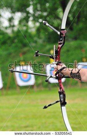

Ok here is an idea. For a rod the moment of inertia will be different for each axis. It will have a greater moment of inertial when rotated end-over-end than around it's long axis.
This would suggest that a vertical bow might be more stable/accurate in elevation than direction. Where as a horizontal bow might be more stable/accurate in direction rather than elevation.
If I was designing a bow I'd be thinking of adding weights on rods to increase the moment of inertial for all three axis. Google images suggests they typically only have one rod projecting forwards, but some appear to have them in other planes...
-photo-archer-pulls-on-the-sport-bow-string-taking-aim-at-his-target-at-the-competition-53205541.jpg
Taking the idea to extreem... Could you mount the bow in a frame big enough for the archer to stand in as well? Obviously you wouldn't be allowed to have it resting on the ground but a big cubic frame with masses at all 8 corners would add a lot of stability in all planes.
CWatters,
Would the bow YOU designed be V or H, all things being equal? Obviously stabilizer rod can and are added for more stability, but we are talking bare bow. No bells or whistles.

I have similar question to that which berkeman asked...
Looking at google images of standard vertically fired competition bows the stabalizer rods normally seem to point forwards. If you set up such a bow and then remove the stabalizer rod would the grouping get wider or taller or both?
I had never seen a vertical crossbow before looking it up just now, but if you have
ever seen a slow motion video of an arrow being fired, it appears to oscillate on the
same axes as the string.
A bolt while shorter and stiffer may still have oscillations.
If the oscillations are on a vertical plane, the inaccuracy would look like
more or less drop, if the oscillation were on a horizontal the inaccuracy would show
up as an error off the center line.
This is just an idea and may be way off the mark.
CW,
Holding the bow at time of shot is going to maximize your accuracy. The front stabilizer primarly controls the side to side torque of the hand grip eliminating mostly L and R error.
