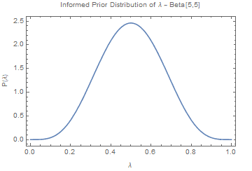

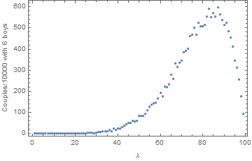

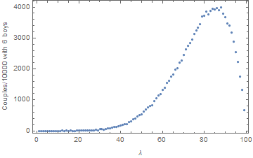

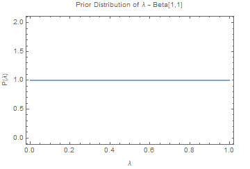

In that case, a Bayesian would use a maximum entropy prior, which basically means that your posterior after the first set of data is whatever the distribution of that data set is.
Most treatments of this type of problem that I have seen would use a Beta distribution since it is a conjugate prior. So you would get ##\lambda \sim Beta(2,7)## for the posterior for both cases separately or ##\lambda \sim Beta(4,14)## if you were pooling the data for an overall estimate.
https://www.physicsforums.com/threa...from-bayesian-statistics.973377/#post-6193429
