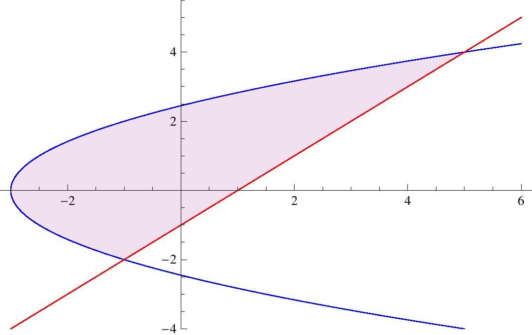

Evaluate (use attached figure for depiction) $ \iint_{R} \, xy \, dA $
where $R$ is the region bounded by the line
$y = x - 1$ and the parabola $y^2 = 2 x + 6$.
I will post solution in just a moment with a reply.
  • Graph in the xy-plane of a blue parabola opening to the right with vertex near (-3, 0) and a red straight line crossing it at two points; the enclosed region between them is shaded light purple.

I would use horizontal strips, where:
$$\frac{y^2-6}{2}\le x\le y+1$$
And these strips run from:
$$-2\le y\le4$$
And so we obtain the iterated integral:
$$I=\int_{-2}^{4} y\int_{\Large{\frac{y^2-6}{2}}}^{y+1} x\,dx\,dy$$
I will leave it to a student to demonstrate:
$$I=36$$
Thanks mark. I will give a little intuition as well and let a student come up with the result. This is just a reiteration of Marks work.
Based off of $\Bbb{R}$ pick to integrate with respect to $x$ first.
This would imply; that the boundaries of the region in the $x$ direction would be;
$x=\frac{(y^2)-6}{2} $ and $x=y+1$.
Now find the range, that is the range of values for $y$. In order to do this we need to find the $y$-coordinates in the points of the intersection between the following two curves;
$y=x-1$ and $y^2 =2x-6$.
Substituting $x=y+1$ into the second equation we obtain;
$y^2 =2(y+1)+6 $
Solve by factoring or quadratic formula to find the roots of the polynomial.
So we have $(y-4)(y+2)=0$ $\implies$ $y=4, y=-2$
Now try to set up the integrals to find the region requested;
I will give everyone a chance to set it up and or solve.

If you really want to use vertical strips, so that you are integrating with respect to x rather than y, you will need to break this into two integrals, one from -3 to -1, the other from -1 to 5.
