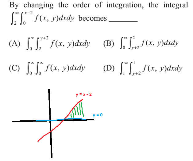

I've drawn graph below.
Currently their limits are y = 0 to y = x - 2 vertical arrow
and x = 2 to x = infinite. horizontal arrow
Changing limits i get right side graph.
x = y + 2 to x = infinite horizontal arrow
y = 0 to y = infinite vertical arrow
But that is not even there in options. Am i wrong somewhere?
What you have done looks right to me. The question is also odd in that they haven't changed the order of ##dxdy##.
