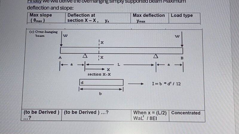

Derive an expression for the slope and deflection for the beam
Deflection of beams
Please help me finding the max slope and deflection im stuck on this problem for two weeks.
I can't get anywhere with the boundary and continutiy conditions
The problem and what I've d one:

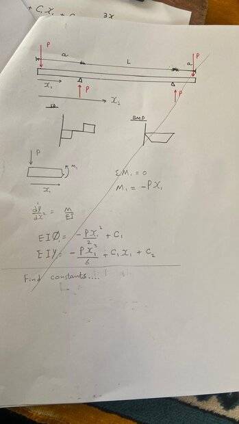

The shear ##V(x)## can be represented with the singularity function:
$$V(x) = -P+P\langle x - a \rangle^0 +P\langle x - (L-a) \rangle^0 $$
Then you can integrate that to get ##M(x)##
Then apply ## EI \frac{d^2y}{dx^2} = M(x) ##.
The boundary conditions on ##y## at ##x=a## and ##x = L-a## give you two equations and two unknowns to determine the integration constants ##C_\theta, C_y##

Thanks for the answer, how is it possible with the normal integration as I'm not familiar with the singularity method.

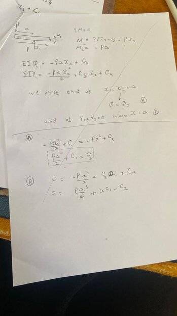

Its messy, but the idea is the same. You will have a bunch of integration constants to figure out. The is a distinct moment curve for each region of the beam between point loads with its own constants of integration in the deflection integration. They have to be all matched up with the boundary conditions on ##y## at a particular point and use the fact that we are not to have discontinuous slope between the segments.
I suggest you see this:
https://eng.libretexts.org/Bookshelves/Mechanical_Engineering/Introduction_to_Aerospace_Structures_and_Materials_(Alderliesten)/02:_Analysis_of_Statically_Determinate_Structures/07:_Deflection_of_Beams-_Geometric_Methods/7.04:_Deflection_by_Method_of_Singularity_Function

I think you are going wrong in evaluating the slope at the first support. You apparently have ##x_2 = a ## in the equation? ##x_2## should not be referenced from the free end ( where ##x_1## is referenced), it should be referenced from the beginning of the segment under consideration. So when you are equating ##EI \theta_1 = EI \theta_2 ## be wary of that (pay attention to the value ##x_2## should take in the ##\theta_2## equation at the first support).
