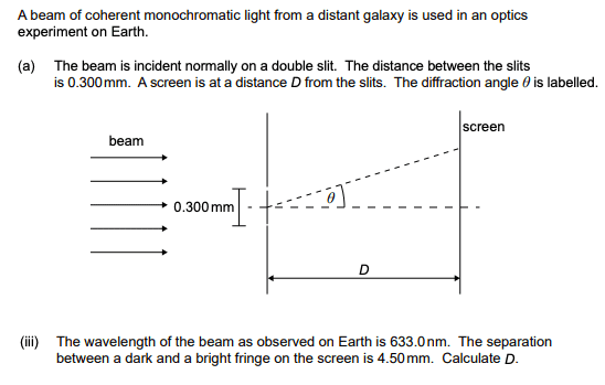

question (iii)
2. Homework Equations
D=sd/λ (where D is the distance from slit to screen, s is the distance to the central maxima, and d is the slit separation)[/B]
I plugged the values s=0.3*10^(-3), d=4.5*10^(-3) and λ=633*10^(-9), and got the answer 2.13m. However, the answer stays that I need to multiply this value by 2, and I don't know why as the formula doesn't say so. Thanks in advance![/B]

Hello youmei, :welcome:
What exactly is the formula saying (what is it for ? ) And what does the exercise ask ?
The formula ##\beta=\frac{\lambda D}{d}## denotes the distance of separation between two adjacent maxima (or minima). But you are given the distance between a maximum & the adjacent minimum.
Can you figure it now?

I came across another similar problem regarding diffraction grating, and there the diffraction angle is from the normal to the first maximum. So I am a bit confused as to what exactly is the angle in the formula? Thanks!
The central maximum resides at the normal (or at the centre). Where should the first maximum occur then? Can you somehow approximately relate this distance to the angle you need?
